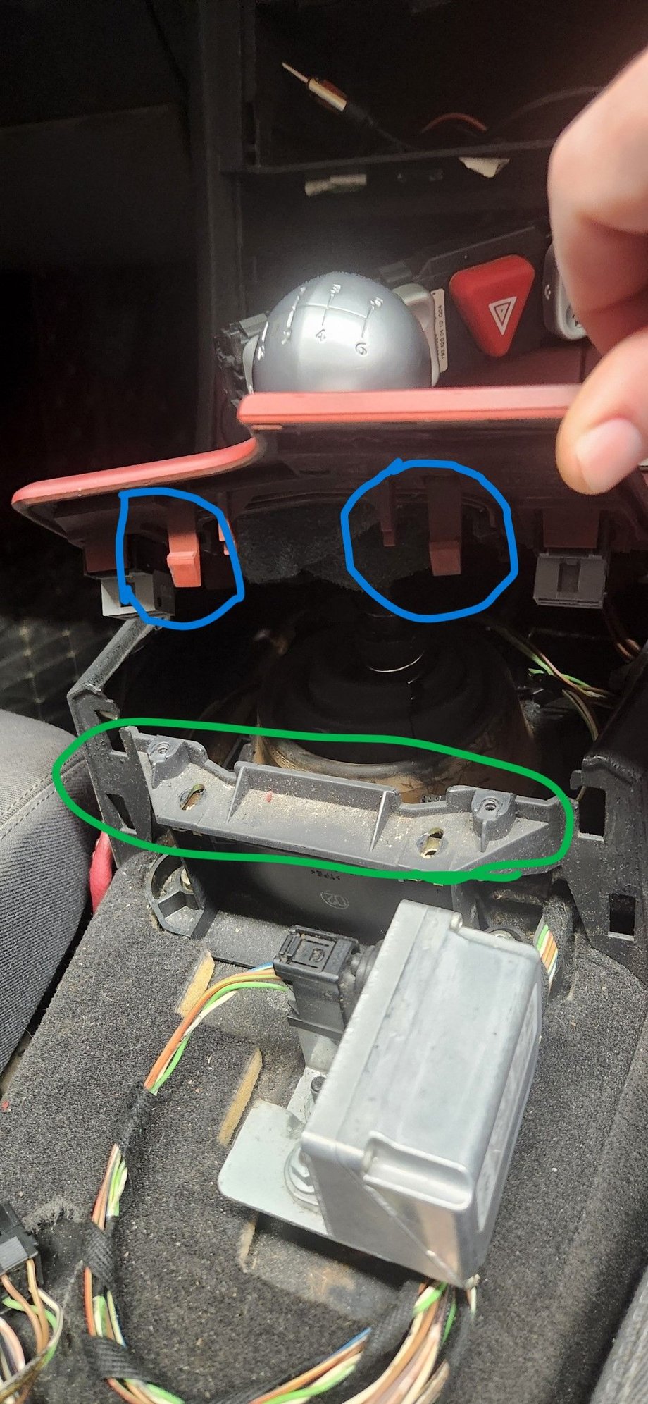

Does anyone have a parts diagram or pictures of the what the shift cover on a manual snaps into to retain the back part of the cover plate in the center console? I think I am missing a piece as the cover plate pops up from the back upon shifting. Where do the tabs circled in blue snap into?
Blue are tabs, green is where something should be

I have a shop manual and sorry the illustrations don't show a good diagram where those hooks clip to but here's a video that may help

Looks like you may need the center of the console reinstalled?

I ended up just using VHB as it looks like there is no additional part that I was missing even when fully assembled. It just wasn't latching in. The console wasn't treated the best during its life so guessing something got bent or broken at some point. It is what it is, and nobody will know until they take it apart again.
