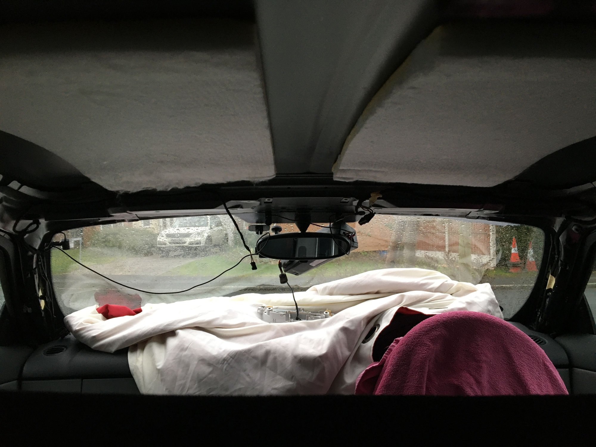

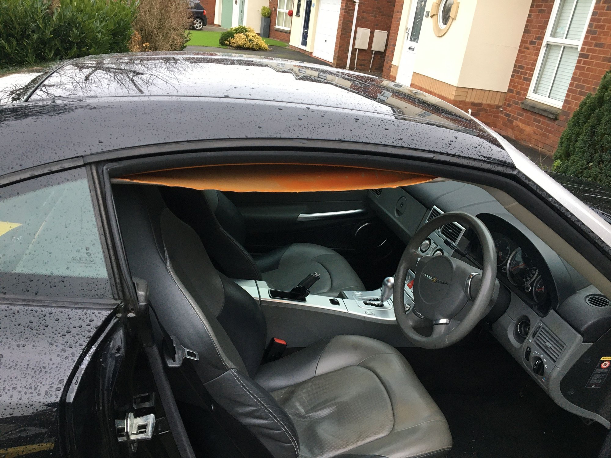

First I removed the headlining from the car, I won't go into detail about this because there are already good instructions on here. Needless to say it's a bit fiddly and you need to be patient and careful with it. You should protect the rest of the interior and dashboard with bed covers or curtains etc before you begin as they will probably be damaged otherwise. I think the headlining was probably fitted at the factory before the windscreen.
Next I removed the fabric lining from the actual headliner panel, it's a messy job and leaves glue and foam residue behind which can be rubbed off with care, when it's all been removed you should be left with a nicely textured headliner, don't try to make it too smooth as the texture gives it character.

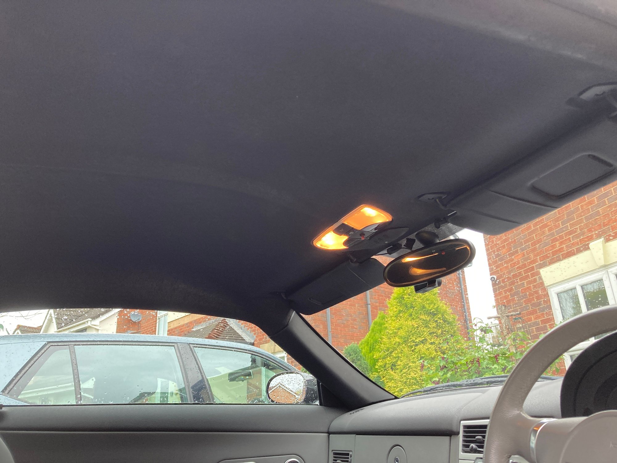

I coloured the hard headliner black with a sponge and some black interior reconditioning stain which I'd bought for the carpets and upholstery of another car, but I'm sure you could use something else or even spray it with satin or mat black paint. I also sprayed the A post trim panels and sun visors with satin black to match. The total cost was a few hours of time and about £10

Headliner removed, covers are essential to protect the interior when you do this
Headlining replaced after being stripped and stained black, the sun visors and A post trims were sprayed with satin black
Removing the fabric has accentuated the characteristic central ridge in the headliner. Another great styling cue of this wonderful car.
