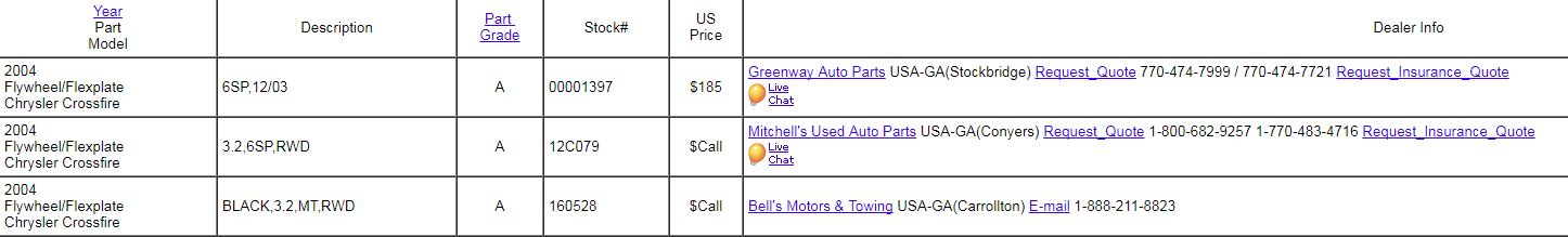

Update ; just found out that the flywheel is bad. Part is over a grand.
would you guys go with anything other than factory?
oh and you get what you pay for. The slave cylinder housing is plastic on the NAPA Part.
so buyer beware,
what will be the impact of this?
will it make a difference at this point to go with a combination after market clutch kit and factory flywheel?

I was always curious if the flywheel from a wrangler with the pentstar 3.8 v6 and pressure plate would work in ours and the clutch for crossfire, slk, r170.
both nsg370 trans but the nsg in wrangler has a different spline shaft so either change the shaft or use use r170 clutch with chrysler flywheel & pressure plate, but on flywheels I pretty sure they both have 140 tooth, 8 bolt flywheels.
if someone who had theirs out of there car to take it to napa and compare to one from a wrangle, would give more options, cost less and be a lighter flywheel, so less rotational weight, get alittle more hp at the wheels
