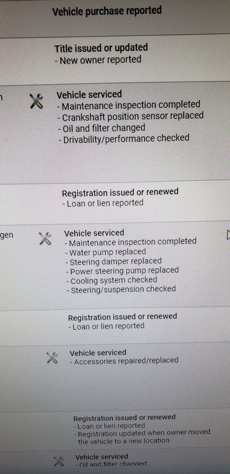

2004 XF 158,000 miles final price $2100
6 owners according car fax
See pic with details on what was replaced at 80,000

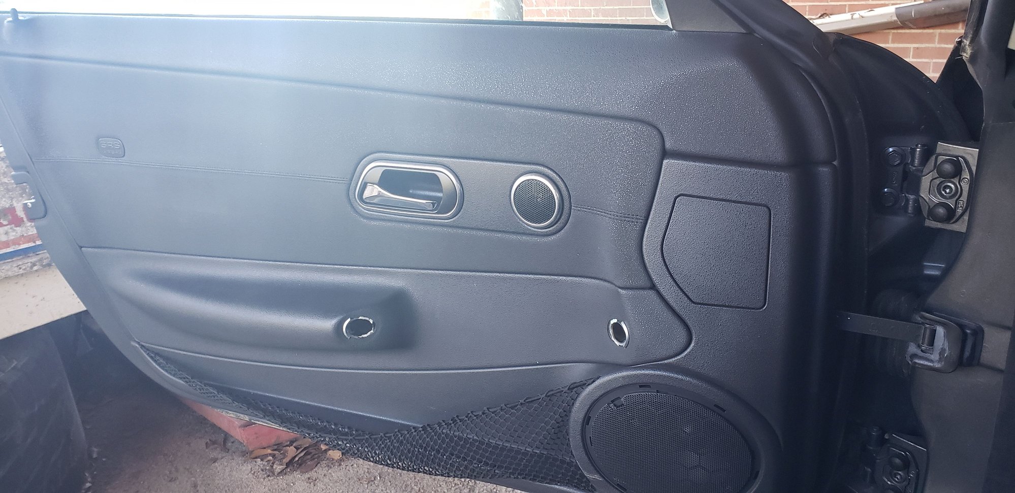

The inspection: so I will list all that I found with pics
1. Windshield has a quarter size spot appears will need replaced it will drive me crazy.
2. The window trim as pics show it's coming off, literally going down the road I was holding it down.
3. The fog light on driver is able to be pushed in but both work fine.
4. The glove box is kept closed by a screw in the bottom
5. The fan speeds seems to have a short they work its basically slow speed, or high speed. No in between.
6.i did not find no rust anywhere. I looked under the door trim and all between the doors and around the trunk and hood.
7. The hood all works fine and the hood release all works good and solid.

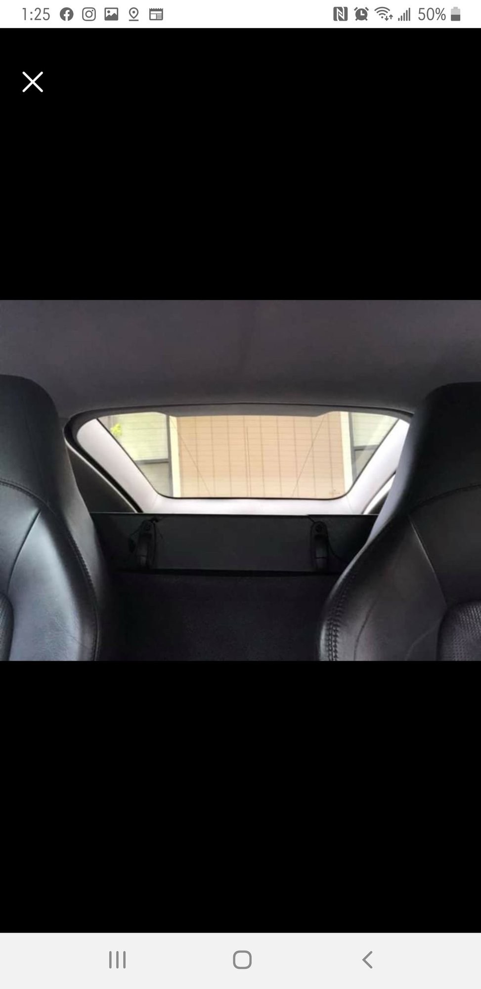

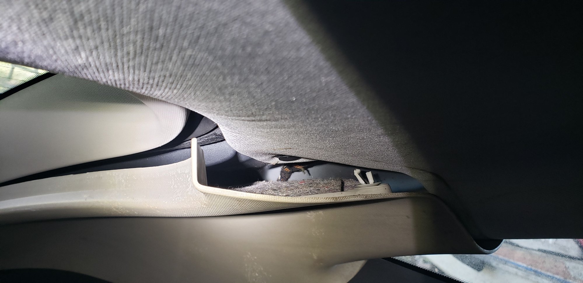

8.The back inside plastic molding coming off appears it could be fixed.
9. The rear view mirror wiggles around alot just not stable sure can be fixed.
10. The side mirrors are solid and tight. Rear defrost works.
11. The windows all go up and down smooth. And also all close tight to the rubber trim.
12. Turn signals and all speakers seem to work good. As I said before heat and ac work great.
13. All the tires seem to be in good shape.
so I will include the pics I took today. And any thoughts ? My wife and I still really like the car. And dont mind doing some basic repairs. But I just dont want this to become a money pit like my jeep was. We loved our jeep but just got to the point constantly needed something. Thank you again for all the help.

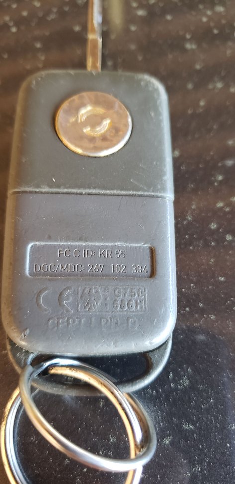

What year, model and color? What is the mileage and price. It seems to need TLC so don't overpay. Does it have two keys, they are expensive, if you can get them. Parts can be hard to get and expensive. I'm not suggesting to not buy it, just balance out expense and time against one that needs less work.

2004 XF grey 158,000 miles
$2100
Car fax showed 6 owners , and primarily a lease car.
The following was replaced at around 80,000 miles see
the pic.

They only have 1 key

at $2100 , and with around $600 in repairs, if you make the cosmetic repairs yourself, you have a good deal the engine is good well over 500,000 miles change the oil Use only moble 0ne 0-40
have the car clayed and polished,,,and enjoy.
