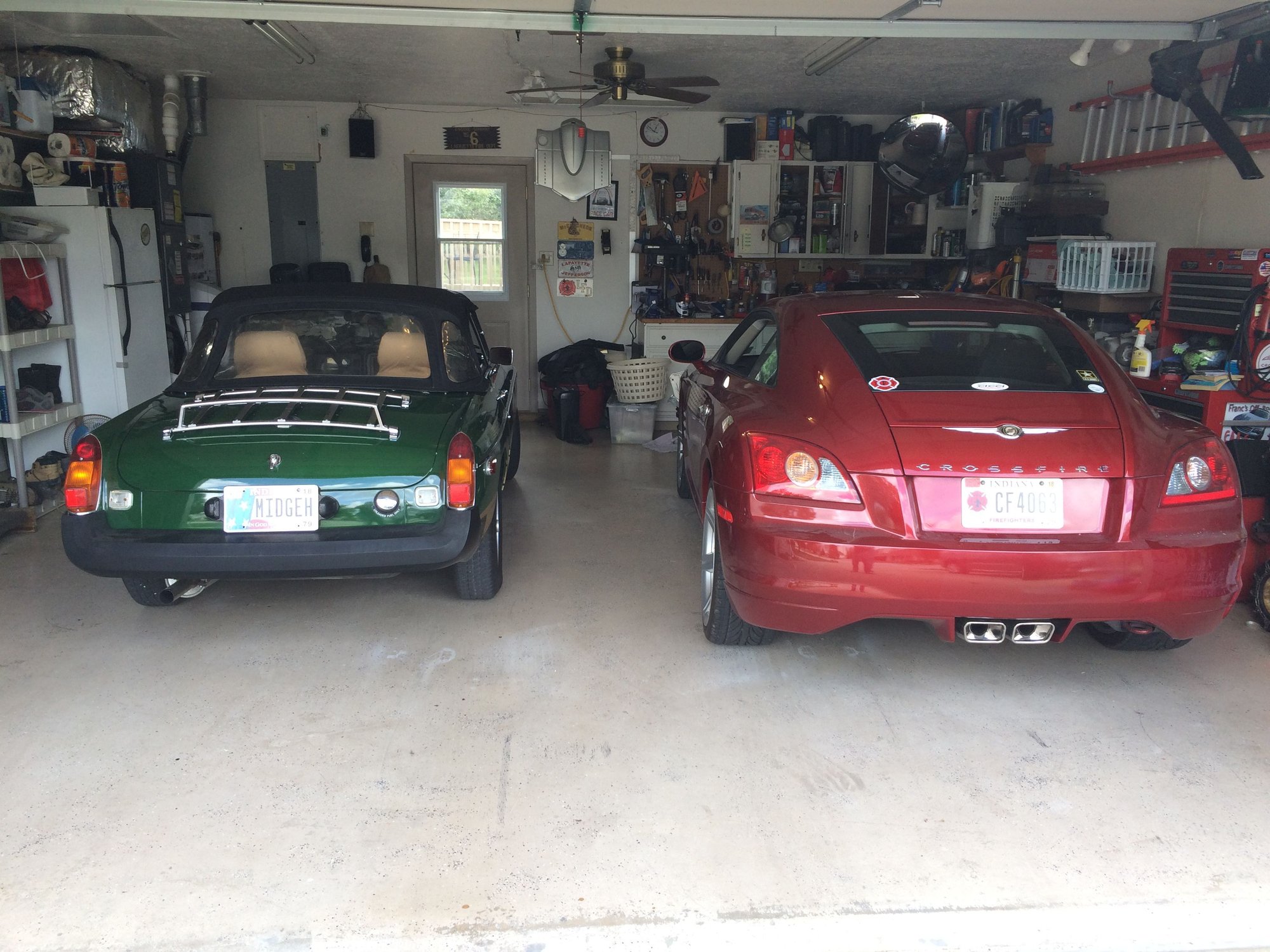

Jeff I still drive mine.
You were a lucky man in regards to the fire. Really enjoyed that surprise story. Great job.
joe
