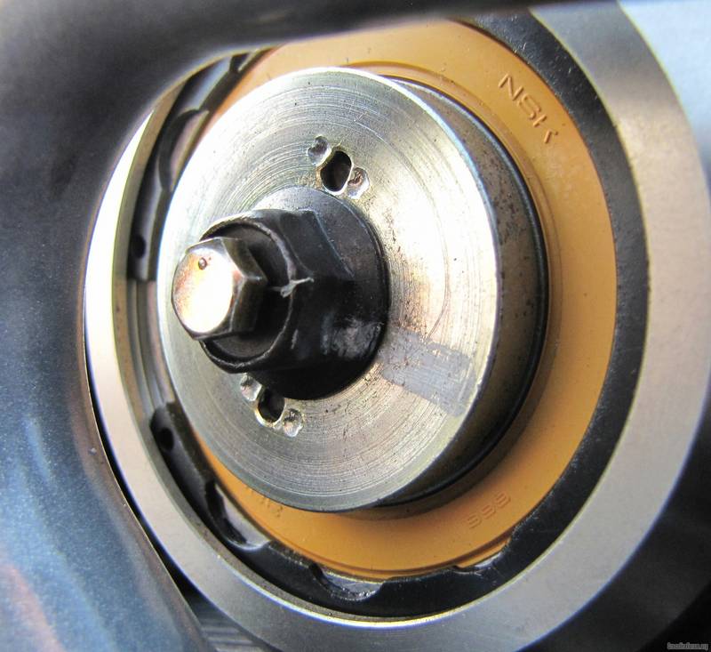

I'll post a picture later of what the local dealer did to my SC bolt. They threaded a smaller bolt into the hollow portion??? Guess they thought it was gonna leak!

Originally Posted by tighed1
Thanks for steppin' in and helping TVT!
Here's the picture.
