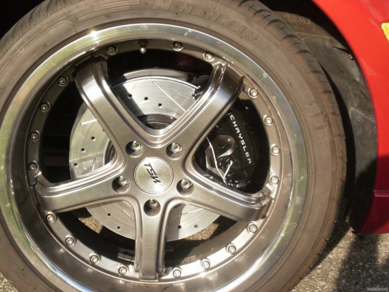

WOW, I wasnt going to say anything but my mech and I couldnt figure out which direction either. I had seen one pic prior to install so we ended up doing it correct. Thanks freakingfast! this set up for the price is the best deal for my car since Ive gotten her....God bless ya!!
NOTE: I noticed was the hub retaining hole in the rear rotor didnt line up with the hub. Not a big deal but was wondering if anyone else experienced this too?
BTW, they look great...AND IVE CLEANED THE WHEELS SINCE THIS PIC

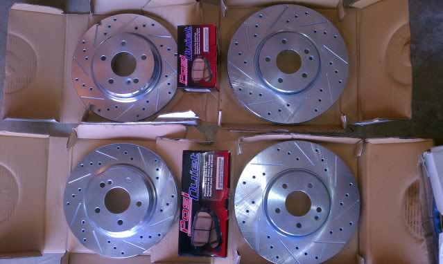

Hey guys I just wanted to show the new restyled SRT6 brake rotors>>>Centric added more slots and drilled hole pattern...Giving it better performance~ While maintaining rotor longevity~! Most companies that are drilling the srt6 rotors are drilling them completely wrong and are weakening the rotor structure and creating more heat~ Centric took a few days of testing this brake rotor and this is what they said would work the best~ anyone can drill a rotor but most don't know what they are drilling into? and they do not take the time to actually look at the inside of the rotor. Since most companies are buying from Centric they know nothing of how these rotors are being built and they are creating patterns that I have seen even on this forum that are just completely wrong. Like the double drilled with single slot design...That rotor should never be used on a srt6 EVER! but thanks for looking guys and hope you like~ This is the best rotor without going to a 2 piece design Period! Centric has also made me a couple of circular designed slotted only rotors that I should have in the next few weeks....
::::NEW::::
::::OLD:::::

these rotors are installed backwards. flip them so the slots face forward to clean the pads

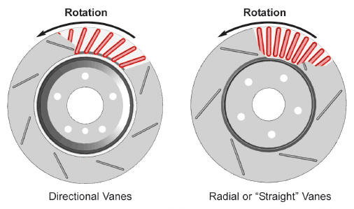

For slotted rotors with straight internal cooling vanes (NA rotors)
The direction of the slots is totally up to you and what you think looks best.
Bottom line - don't use the slots to decide which side to mount the rotor. Pay attention to the internal cooling vanes.

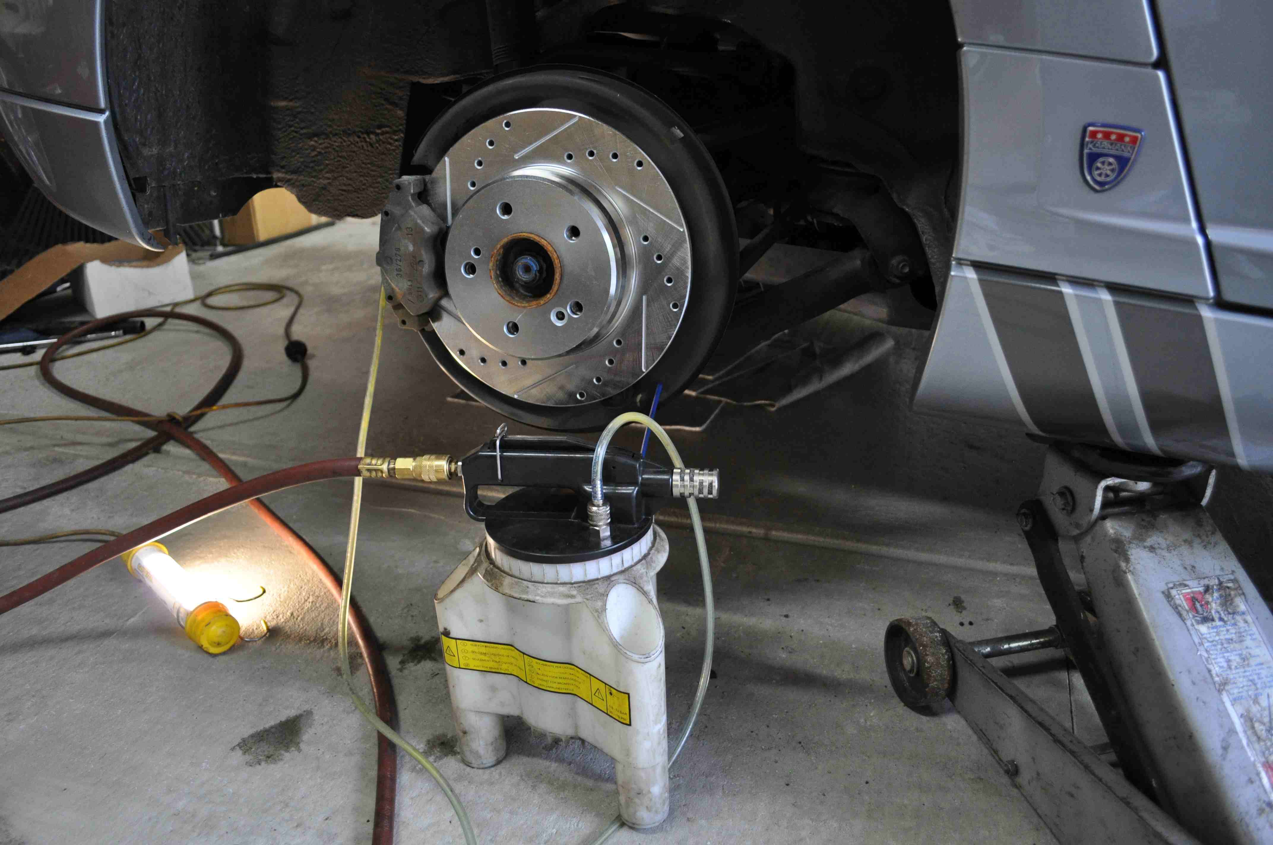

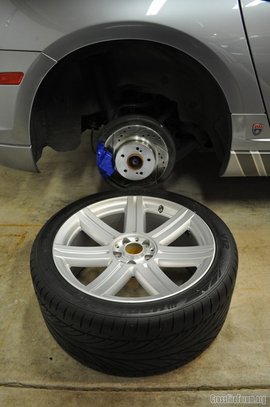

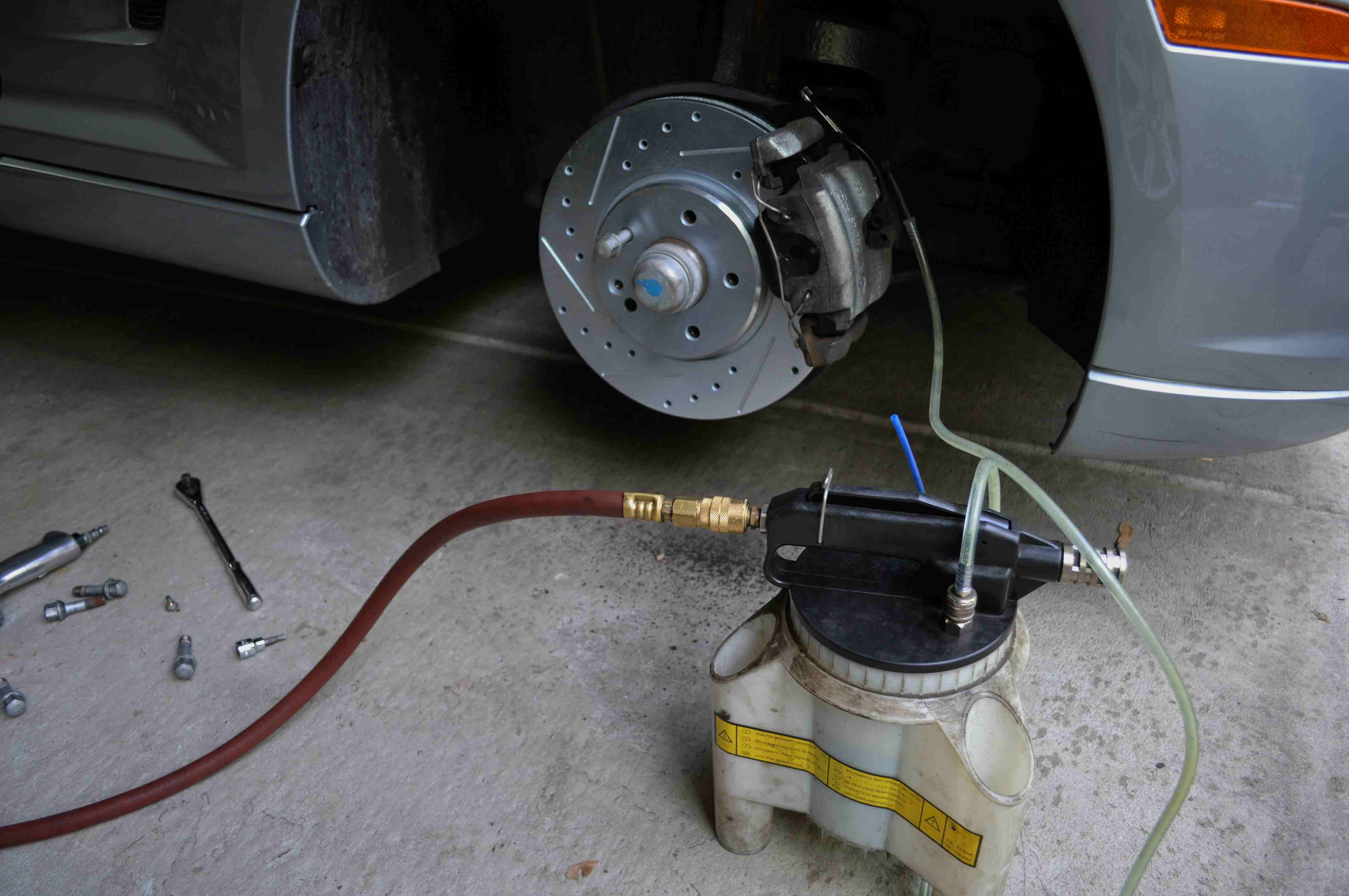

Here is my install..... LF> RF> LR> RR>
As Marc said...On our na Crossfires the rotors DO NOT have directional cooling vanes inside therefore the direction of the slots is optional.
Just be sure you install the front drivers side and rear drivers side with the slots the SAME way.
Same goes for the passenger front and rear.
I chose to install with the slots pointing forward as the wheel comes around to the top.
My theory is that brake dust if any would be thrown toward the inner hub and not the outer side of the rotor and onto the wheels.
I have had absolutely NO brake dust NO noises and the rotors are shiny and still look like new with hundreds of miles already on them.

In summary......
The direction of the slots on the outside of the rotor do not dictate whether the rotor is a left or a right.
In this case, there is no wrong answer.
