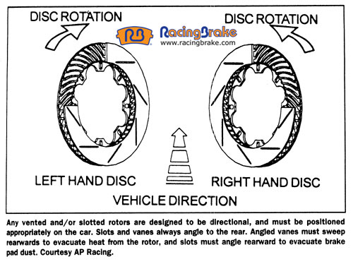

BTW something that I wondering about is there a left and a right for slotted rotors?
I'm getting a considerable amount of brake dust with these pads and Valk mentioned the slot can run either direction.
Please understand that not everyone is as knowledgeable as everyone else, which is a nice way of me telling you to keep your sarcastic comments to yourself.
I'm a 51 year old female and have never installed brakes let alone rotors. That I did any of this is good let alone twice. I couldn't understand a clunking noise problem and disassembled them the second time to sand the contact points and verify they were safe.
So anyway, is this correct? It would make sense that there would be a R/L. That the slot is "cutting" with or against the pad.

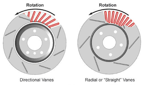

In regards to the direction for install, the slots and holes don't matter. What matters is the orientation of the vanes in the rotor. If the car is moving <---- this way, then the top of the rotor's vanes (as seen from the left side (driver's side for us southerners)) the vanes should be /////. As if the vanes were "flinging" the air away from the hub as they roll. Not "catching" air. Like a squirrel cage fan. Oh geeze, this link might work better:
http://www.racingbrake.com/v/images/disc_rotation.jpg
If the vanes in between the rotor's halves are straight, then put them on the way you think they look the coolest.
Nice brakes. I'm sorry I didn't catch who made the rotors, care to post?

Thank you aftcg, something tells me I'm redoing at least one pair of rotors ......arg
One other thought could the dust I'm getting now be "left over" from the OEMs?

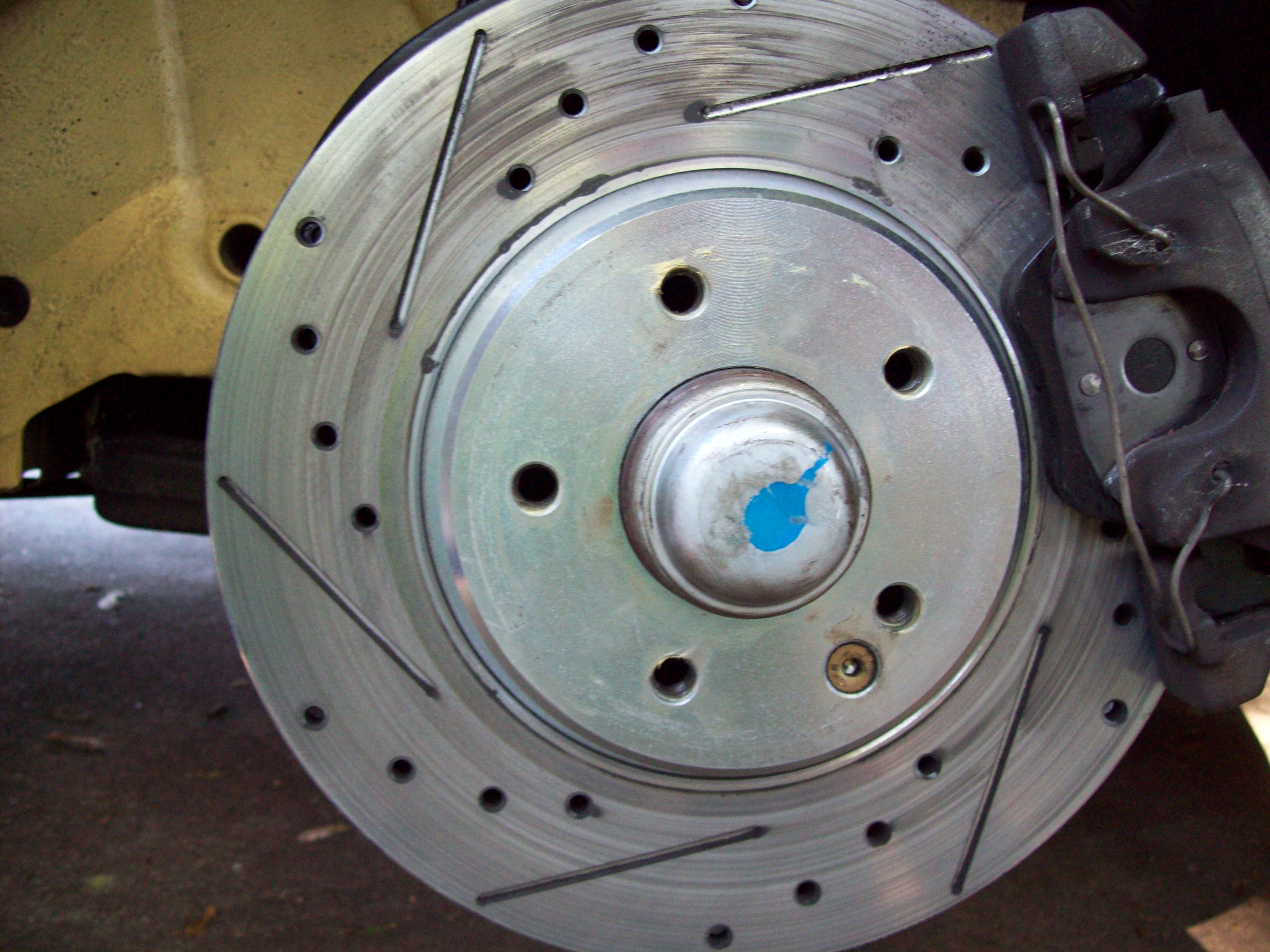

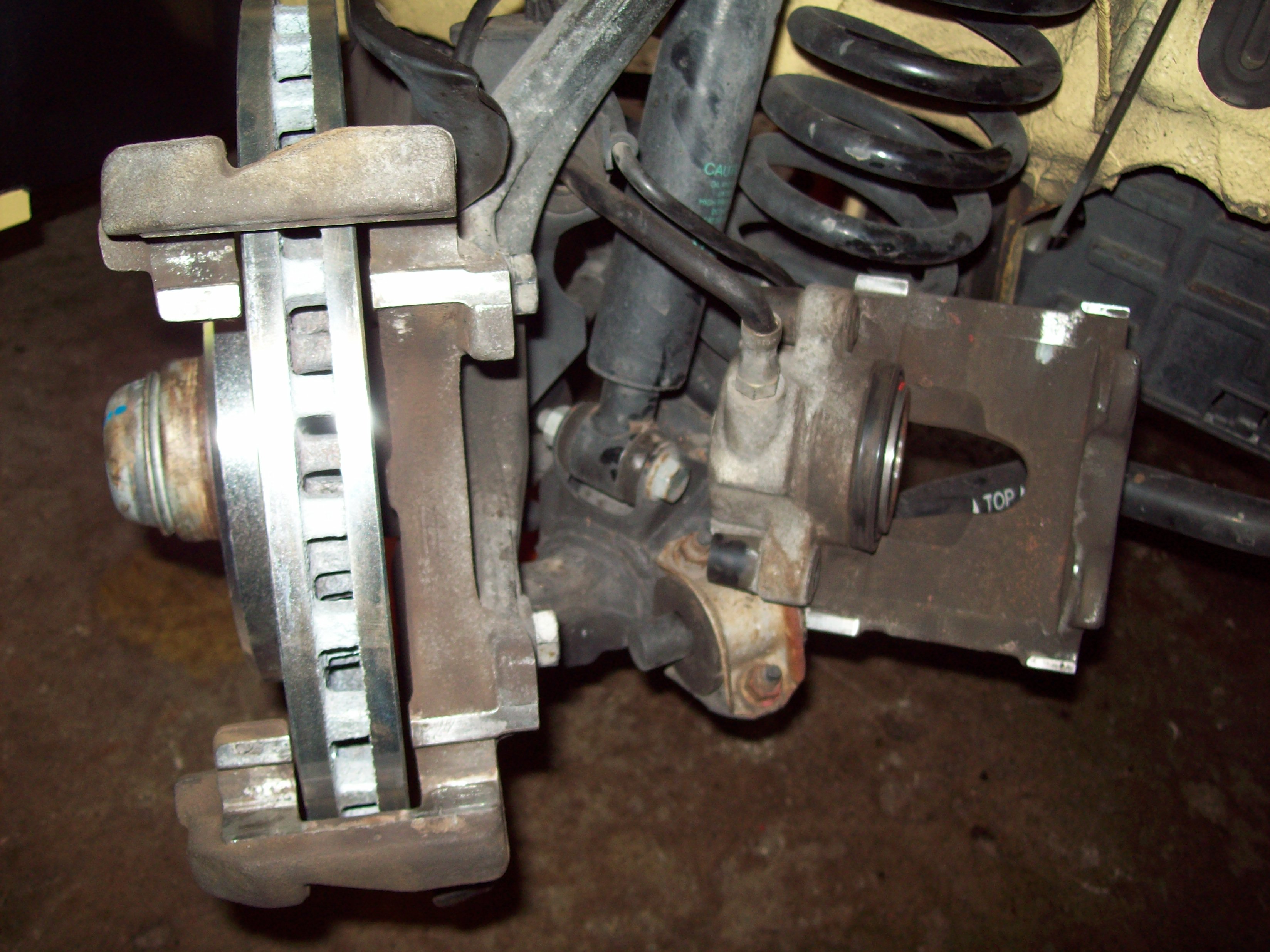

Checking general info on line I found this from a racing rotor manufacturer:
"For high performance applications the slots and vanes (if curved) should always angle to the rear. The curved vanes must sweep rearwards to evacuate heat from the rotor, likewise the slots must angle rearward to evacuate brake pad dust."
These pictures as well. Marc let us know about the specifics for these rotors. My fronts and rears do not rotate the same direction currently.

Good info to have Rapp's, I to was confused about this when I was going to put these on my wife's Taurus last year. I had to research it myself but if I remember right ( and that is a story in itself!) the ones I purchased were marked R & L.
PS I saved your pictures for later reference, Thanks

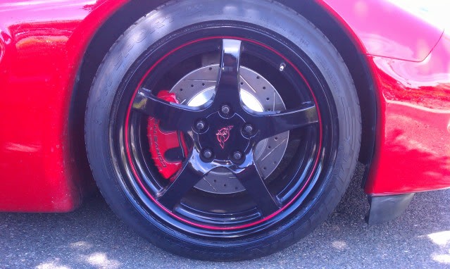

driver side mounted
passenger side mounted

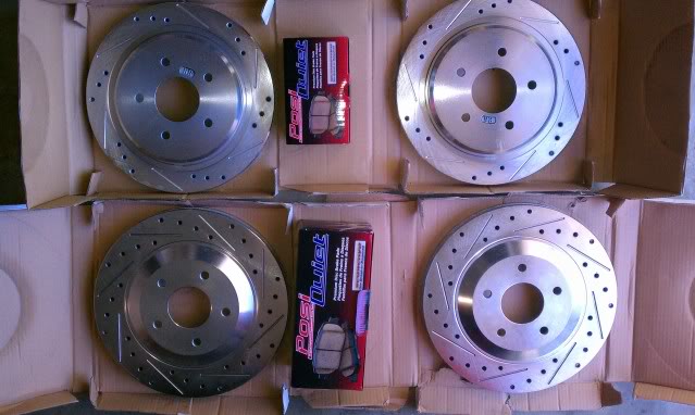

Now in terms of the way they should be mounted would be the way the vein direction is....in the case of the crossfire N/a there is not a directional vein. So really is up to you the way you want to mount the rotors....But make sure left and right side are going in the same direction, meaning the front left and the rear left side brake rotor should be mounted in the same direction not opposing each other. Which way is up to you. Reason being is the Rotors the N/a crossfire has are straight veined. On the srt6 is a different story as the veins are directional.
the rotors on the left are passenger side rotors and the ones on the right are drivers side. Again its up to you in terms of direction but this is the way I mount them. Also my vette rotors are directional and thats how they are meant to go...
hope this helps

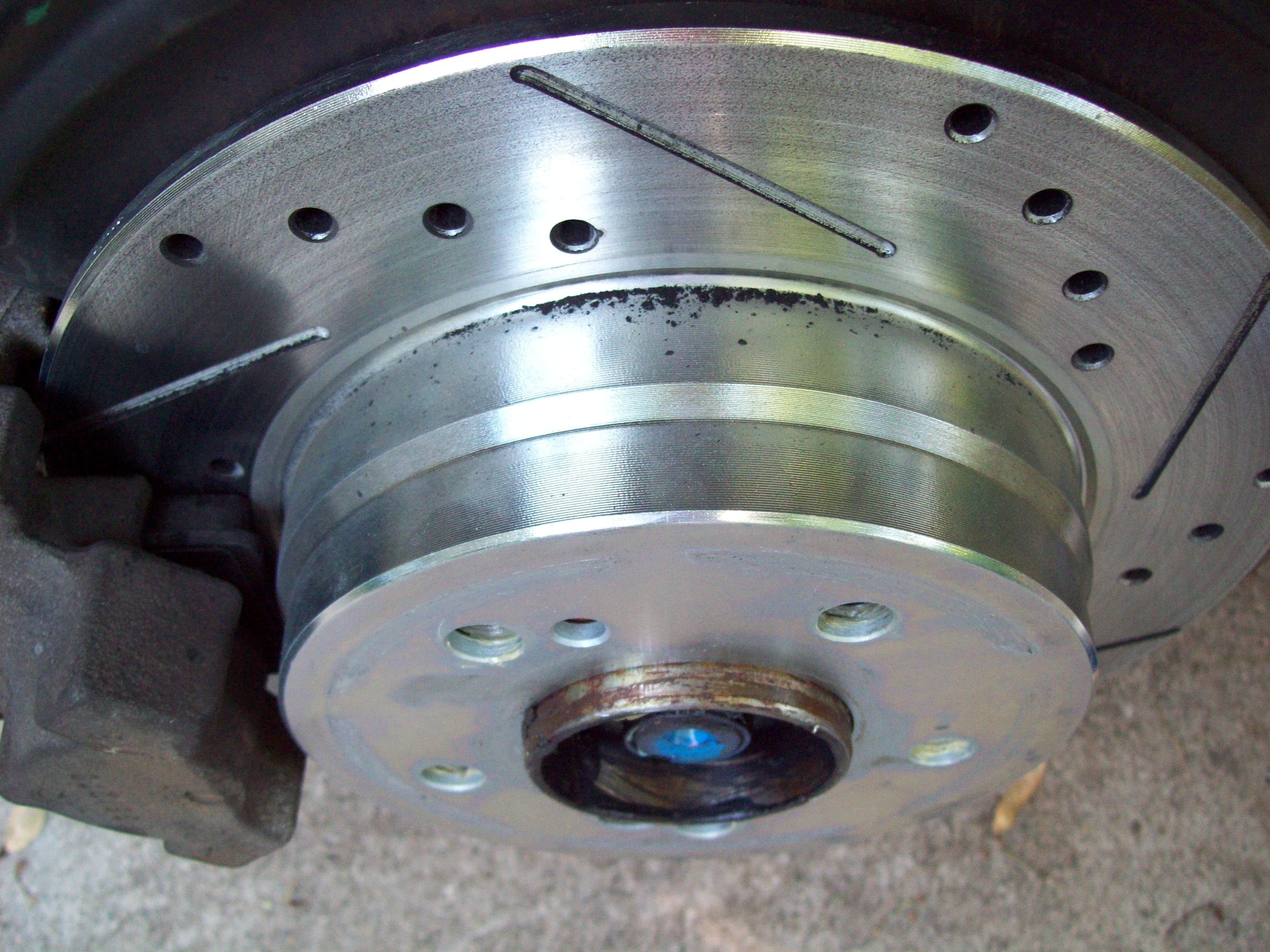

Howdy Marc, for those who haven't spoken with him, he and I went over some of this on the phone over the holiday weekend, he's generous with his time
OK first off, cool wheel color combo for the Vette, now if you can fix the car so that it's a Viper you would be all set!!
I had said:
"disassembled them the second time to sand the contact points and verify they were safe"
I cleaned up/sanded off the ample layer of rust from the calipers where the pad's "tabs/hooks" sit. The thinking was the noise was mechanical, not brake squeal, so why on all 4 wheels did I hear this God awful noise at any speed when I punched the brakes? It could of been that the pads were loudly complaining as they moved (they do slide a little from the piston movement) over that rusted caliper area. One other point if you do sand these spots on the calipers put some lube on after. We had this product that was made for doing this, just a tiny amount as well.
The "and verify they were safe" is because we were leaving for a GTG and didn't want to find an oh $hit while on the road. After the second time the noise was still there, but after our trip to Fleetwood in Canada it's gone, so I feel it's become a non-issue at this point only because I think my "miss-matched directional front/rear" rotors may of played a part initially. The miles from the trip seemed to of stopped the noise, but the rotors still need to be swapped out to make front and rear match.
I was suspicious that the dust, which is black black black and now dissipating, was from the wheel well area. I had sprayed and cleaned the wells up, also used compressed air to blow everything, but that stuff is so fine it hides everywhere. I have to say I've taken the wheels off 3 times and washed them completely, the black dust was still pretty heavy. The rotors had it packed in the slots and holes too.
This is on a car that always had the wheel wells washed out/up so if someone hasn't been cleaning the dust off I can imagine they would see black dust for a while.
Attached are pictures showing the dust on I believe a passenger rear and front. Also a shot of the spots where I sanded the rust off the calipers. The pads and rotors have not made any of the squeal noise some people claim ceramic pads will have and they stop the car great! Some butt head came inches close to side swiping us in Canada my car stopped neck snappingly fast!
Also credit to my loving husband who is the person who jacks the car up and physically gets the wheels off. My hands are not strong enough to do that stuff. Also I have him check my work so if I screwed up he'll catch it. Thank you sweetie.
(FYI Marc the set screws fit on all 4 rotors for our sets)
Attached Thumbnails Centric drilled and slotted rotors complete with posi quiet brake pad set for sale-passenger-rear.jpg   Centric drilled and slotted rotors complete with posi quiet brake pad set for sale-passenger-front.jpg   Centric drilled and slotted rotors complete with posi quiet brake pad set for sale-100_5991.jpg

Okay so first The black dust your seeing is not from the ceramic brake pads...as these ceramic pads do not produce this color dust at all....My suggestion would be to first take brake parts cleaner clean all surfaces, Rotor, Backing heat shield, Brake caliper, wheels inside which sounds like you have already...one thing alot of people tend to forget while replacing brakes is to clean off all oil residue of the brake caliper and rotor...Parts cleaner only! This layer of grease when heated will do exaclty what you are seeing. I can see on the rotor itself that there is a layer of grease that looks to be melted into the metal all over it which is giving all that black dust. I would also suggest using a stop sqeek made by Mcc that you pour into the brake pads...This will completely eliminate brake squeek 100%...good job on the compressed air as this is a crucial step in trying to eliminate all of your tared on dust! but aekm sure to use brake parts cleaner as well! Also LUBE IS THE ENEMY WHEN IT COMES TO BRAKES!!!! Make sure nothing is around the brake rotor or pad! Like I said you will hear horrible sounds and that black dust will come through while tacking up your brake pads!
So I'm thinking alot of the issues in your case were grease and oem wear related and sounds like they are starting to burn off the more you drive??? So my advice give it a month and see where its at??? If the pads are still not clearing send them back to me and Ill have another set of pads out to you~!

As Marc said...On our na Crossfires the rotors DO NOT have directional cooling vanes inside therefore the direction of the slots is optional.
Just be sure you install the front drivers side and rear drivers side with the slots the SAME way.
Same goes for the passenger front and rear.
I chose to install with the slots pointing forward as the wheel comes around to the top.
My theory is that brake dust if any would be thrown toward the inner hub and not the outer side of the rotor and onto the wheels.
I have had absolutely NO brake dust NO noises and the rotors are shiny and still look like new with hundreds of miles already on them.
Here are my install pics: Post 77
Also some good info can be found here:
How to properly install plain, slotted, or drilled brake rotors
In summary......
The direction of the slots on the outside of the rotor do not dictate whether the rotor is a left or a right.
For slotted rotors with straight internal cooling vanes (NA rotors) the direction of the slots is totally up to you and what you think looks best.
In this case, there is no wrong answer.
Bottom line - don't use the slots to decide which side to mount the rotor. Pay attention to the internal cooling vanes.
