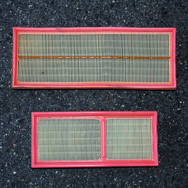

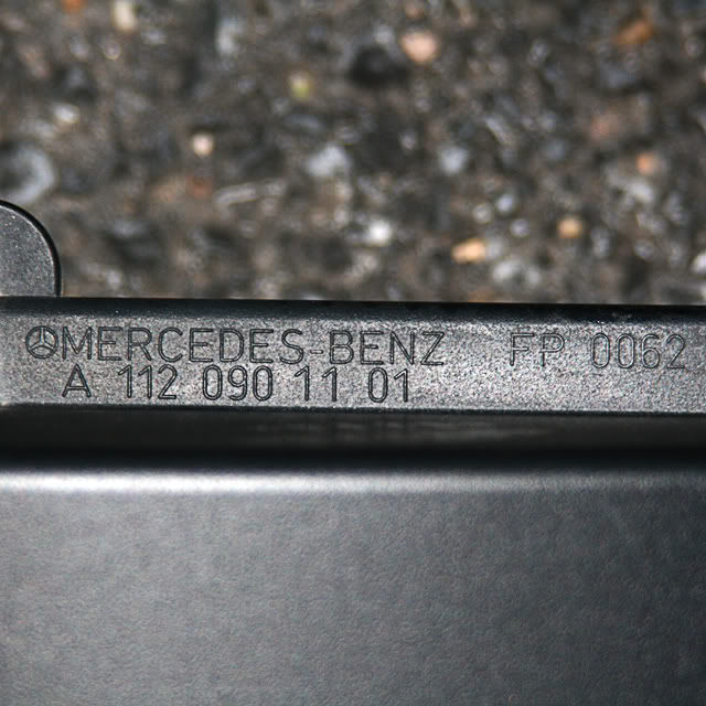

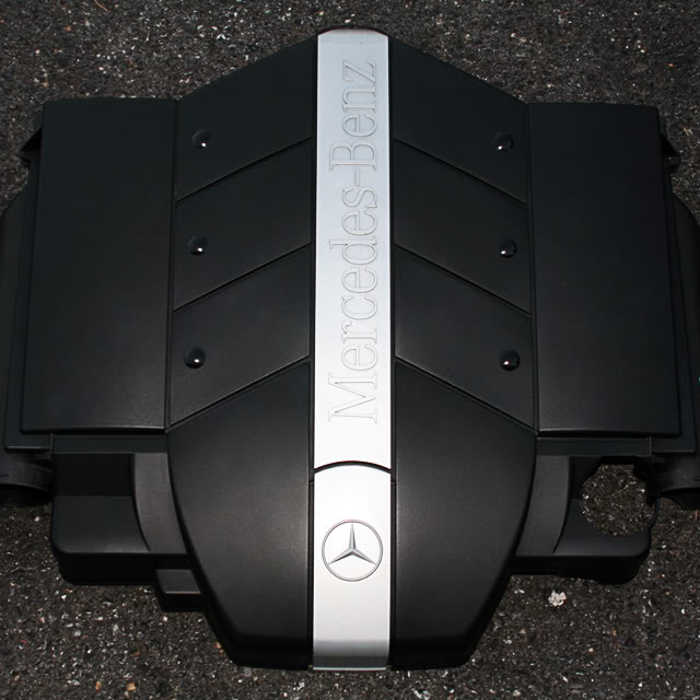

Default Re: Finish off that MB air box - ebay
Originally Posted by dtinker
What are the P/Ns for a LTD N/A. Air box parts, air tubes, etc.
I bought a larger air box than the N/A crossfire... It's a C320 air box as pictured below. The SRT filters are about an inch longer than the N/A ones where as the C320 airbox is longer and wider:

The top filter is the C320 the bottom filter is the Crossfire's

Mercedes engine cover #A 112 090 1101
The front part of this two piece cover is part #A112 010 0467
Intake tubes, left #A112 094 35 82, right #A112 094 34 82
Filters, K&N's #33-2181
The intake tubes have to be modified to fit through the radiator support holes if you decide to use them.
Donut seal for engine cover to MAF unit, Mercedes #1120940180 (If original is damaged)

Oh man that filter looks huge compared to the other one. Was the C320's airbox also a simple bolt on? i can't decide between getting one of these or the normal slk airbox. Any recommendations?

c320 hands down. Using the SLK320 cover will give you no advantage, performance wise. James
These Airboxes just push on with identical spring clips to the Crossfire OEM airbox, no modifications are necessary.
