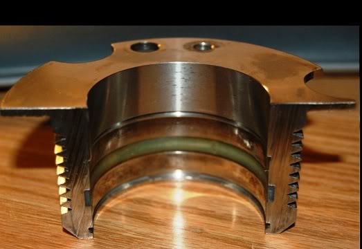

You can only machine down a stock pulley to about 67 mm from 72 mm. This due to an undercut that you can see inside with the bearing removed. Eurocharged Houston has had my 65 mm since Sept. to send it off for a new dog bone spring.
I had forgot about the u/cut.
Here is a picture of it.
