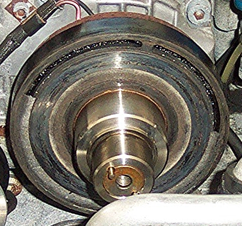

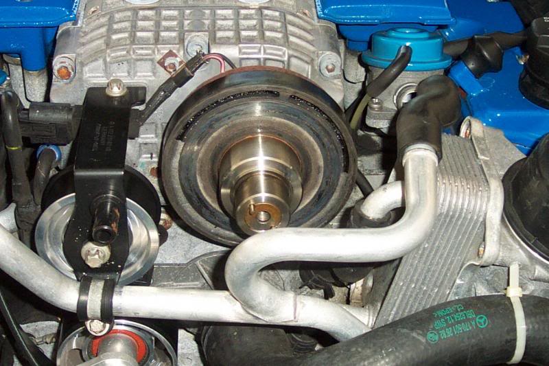

My supercharger clutch went out ive tested everything and i know its the clutch, so i need a new supercharger as the clutch is a part of the housing, ive been told by some that i can remove the shims and drive the supercharger full time with out the clutch but im afraid ill mess up the motor or ecu, anyways if someone has a used supercharger id love to do a core exchange or something as im very tight on money but i need my car back up and running ASAP!

I have a used supercharger you could use for parts. It was removed from my low mileage SRT6 when the face of the electromagnet was damaged. The electromagnet itself is fine and in fact everything still worked. You could probably remove and disassemble the front section of the supercharger including the electromagnet to get the parts you need to rebuild your electromagnet. Let me know if you're interested and I can take more photos. I was going to list the whole used supercharger for $250 including delivery to anywhere in CONUS.
I WOULD suggest that you first get some advice on exactly if / how the electromagnet can be disassembled to be sure that you could use the electromagnet mechanism from this one and the undamaged electromagnet face from yours. I have no direct knowledge / experience on that. Also here are a couple links to companies that rebuild our superchargers (but they are not cheap) . . .

Note: The photo provided below came from Onehundred80 . . . It is NOT my supercharger (which has never been disassembled)

I do not understand what has gone wrong with your SC, removing shims will not fix it if the magnet failed. If it is the pulley assembly itself then there is less of a problem.
