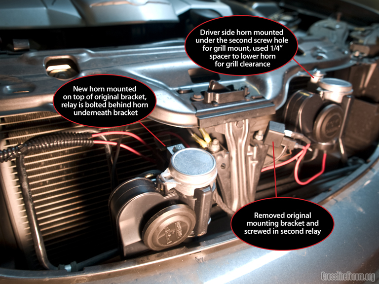

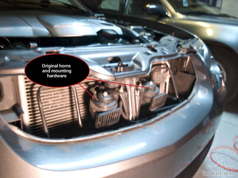

Just finished installing a pair of STEBEL Nautilus compact tuning horns. Great sound, and loud enough to blow a woman's clothes off!
Not to hard to install, but really tight for space. I've enclosed some pics.

The passenger side horn fits below the factory bracket and the drivers side had to be mounted up high under the top cross member. It might fit but its still pretty tight on space, check out the pics above.
