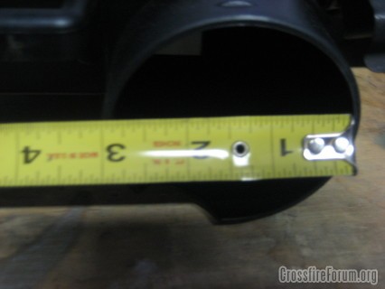

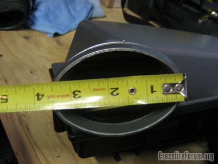

Not the SL55 airbox - but you can fit a V8 MB airbox (bigger filters and snorkel tubes) with some minor modifications onto the N/A Crossfire. It's been done several times with no MAF issues.

OK, but when I look at Steve Hellums and MikeR engine covers (which both have SL55) am I seeing one with modded air boxes and one without?
Steve Hellums only has the Y and intake hoses, which he had to mod so they would work with the stock air boxes. While MikeR, BB and myself have the complete setup (air box, hoses, Y).
Steve used just the SL55 Y-Pipe that goes from his factory airboxes to the throttle body.
The bottom picture is a complete SL55 intake - (Airboxes, Y-pipe, Snorkel tubes) The SL55 airboxes are 25% larger in size then the factory SRT and the I/O ports are 3" so you get a true dual 3" CAI to feed that hungry SC.
You can see by the below picture that the silver paint is just a touch off. Nothing a spray can and some clear won't fix.
