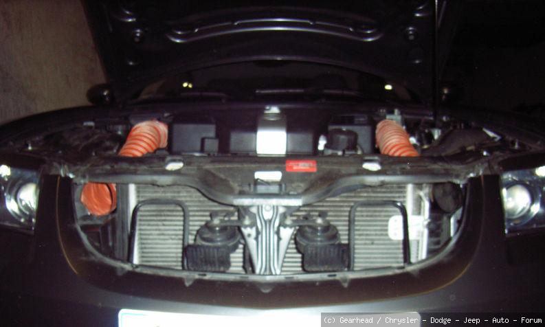

Old Jun 1, 2009 | 05:01 PM
DeepSurge's Avatar
Posts: 48
Default Re: X-fire Air Scoops?
Hi gang!!!!
Well, here it is. I put it together this weekend. MB air box, K&N air filters and TVT air inlets (picture). I also modified the front grille as suggested in this thread
CrossfireForum.org> Technical> TSBs and How-To Articles
grille mod with pic.
https://www.crossfireforum.org/forum/tsbs-how-articles/24738-grille-mod-pic.html
…..it allows the air to flow right into the intake without the interference of the front grille deflectors. Great suggestion by AMX1397.
Next step maybe injectors and ECU form TVT.... Group Buy anyone?????
Enjoy your ride....
Old Jun 1, 2009 | 05:29 PM
G3arh3ad's Avatar
Posts: 55
From: Munich, Germany
Well done! And thanks for the link to the grill mod. I've thought about that but now I know that it makes sense - so I know what I'm going to do tomorrow after work...
I have the same setup like you do now - MB-Airbox, K&N's, larger Inlet-tubes - plus the 74mm-Throttlebody. Did you also notice a different intake noise - a bit louder and more aggressive. Or is that just my imagination?
Old Jun 2, 2009 | 11:31 AM
DeepSurge's Avatar
Posts: 48
Yep, you are right on the money. It breathes better. I tried to make a quantifiable measurement that gives me an idea of what has changed in the dynamic chapter. So I went for 1) fuel efficiency and 2) mph @ 3000 rpm (same portion of hwy in sixth gear).
1) Fuel efficiency: Since I just did the mod. this weekend is really too early to tell how has been affected but BEFORE the mod I was getting 23.77 mpg or 9.89 l/100 km (that’s 14 last gas receipts, topping tank and dividing by trip odometer). I have a limited/ manual. Mostly suburbs, same itinerary, only summer. Some days berserk others really calm. I will update (if interested) once i have results of fuel effc. AFTER the mod.
2) Performance: Surprising. Did test same portion of hwy (between two same exists heading north) and I came up with BEFORE 72 mph @ 3000 rpm 6th gear AFTER 82 mph @ 3k rpm . I did the test just 4 times but I believe accurate.
I’m planning on further mods down the road. TB is indeed one of them!!!! About the sound of the new intake…I’m sure you are right, hard to tell, my stereo is always too loud even to hear my own thoughts….a shame….the x fire is my evasion POD.

Old Jun 2, 2009 | 11:43 AM
spensley's Avatar
Joined: May 2006
Posts: 1,172
From: NC
Now I'm no Einstein - many people will vouch for that!
And I'm certainly no expert when it comes to engines etc.
However, all you have done is changed/modified the air intake, you have not changed the gearing.
Therefore I do not see how all of a sudden you are gaining an extra 10mph (from 72mph - 82mph) @ 3000rpm. Sounds like you've miscounted your gears somewhere.
You have not changed the gearing or wheel size. If your stats are correct then your mpg will raise dramatically.
If this is the case I suggest you patent this and start your own business - you'll make a fortune with today's gas prices.
Working on your theory, we could add nitrous and at 3000rpm we would be making about 75hp more and be doing a speed of about 112mph.
I'm sorry, but something is wrong somewhere.
I don't care how many times you make that run, just adding more air (or fuel etc.) will not affect the speed at any rpm.
