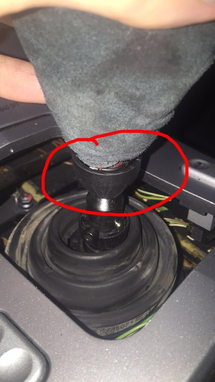

Old Aug 3, 2017 | 02:04 AM
Linc21's Avatar
Joined: Aug 2017
Posts: 6
From: Kansas City Mo
Default Re: shifter **** removal
So I'm trying to take my shift **** off to replace it, and I can't get it off.. lol I have the plastic piece at the base un tightened and was pressing down on it, but it won't come up! Anything I'm missing?? Here's a pic I have that plastic piece in tightened what am I missing? Why won't it come off? Lol
Old Aug 3, 2017 | 05:45 PM
Likes: 650
Originally Posted by Linc21
So I'm trying to take my shift **** off to replace it, and I can't get it off.. lol I have the plastic piece at the base un tightened and was pressing down on it, but it won't come up! Anything I'm missing?? Here's a picI have that plastic piece in tightened what am I missing? Why won't it come off? Lol
Try this.
CLICK
Old Aug 3, 2017 | 11:11 PM
Linc21's Avatar
Joined: Aug 2017
Posts: 6
Try this.
CLICK
I've tried.. I have the plastic piece all the way un tightened. How firmly do I have to pull up? Lol it doesn't want to come off haha I've pulled pretty hard I thought for it. It pulls up like if you were pulling up to go into reverse, but the **** won't come off lol
