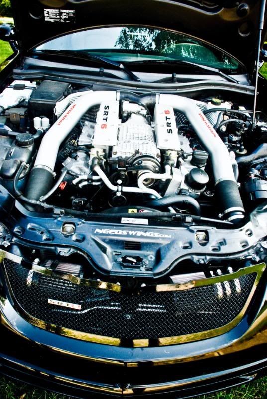

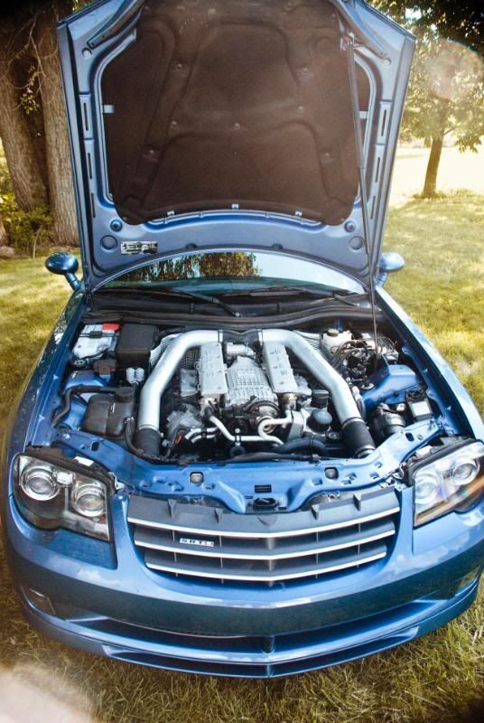

Rare.....Black you have friends all around London....you need to hook up with the rest of the crowd over there....anyway, Max won't steer you wrong....he's built a few good lookin' ones....here's mine, both Needswings CAI's
