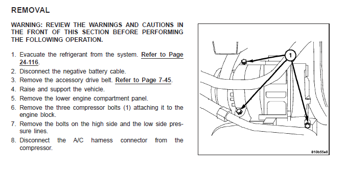

The question is, have you guys tried that ? How hard is to access the compressor ?

to remove the compressor :
