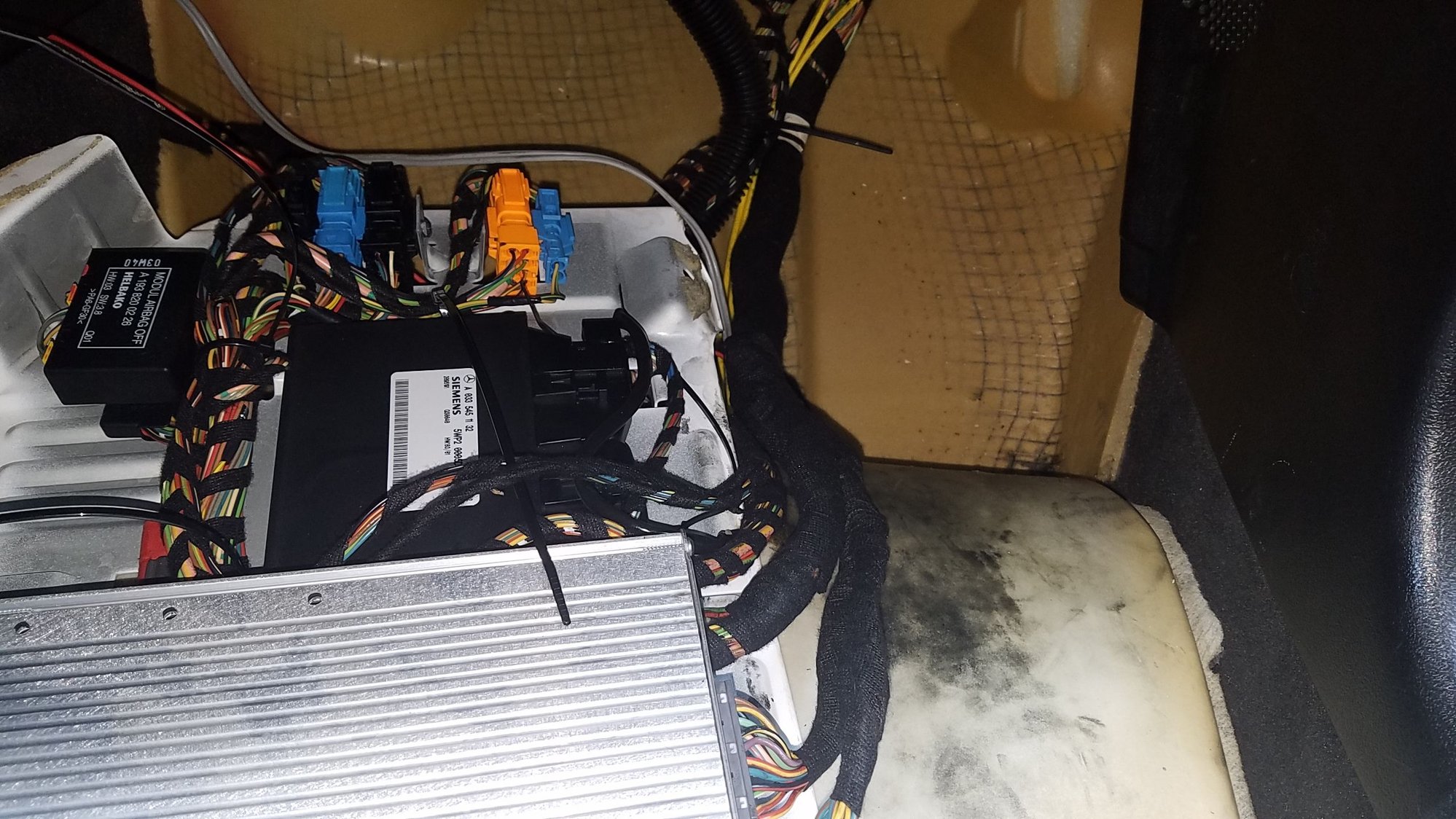

In order to make the audio output work properly, I have modified the amplifier and separated the sub channels from the front channels. From here, I added a 7 band equalizer that has an optional auxiliary input for my SiriusXM. I plan to have this auxiliary
switch to be controlled through the tablet UI as well
pig tail wired for easy assembly - Connected to the equalizer
https://cimg1.ibsrv.net/gimg/www.cro...6e5df09d59.jpg
Final after wires re-wrapped
