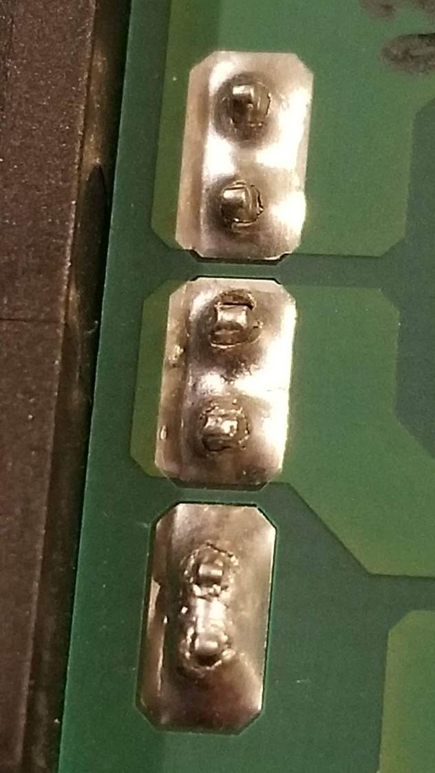

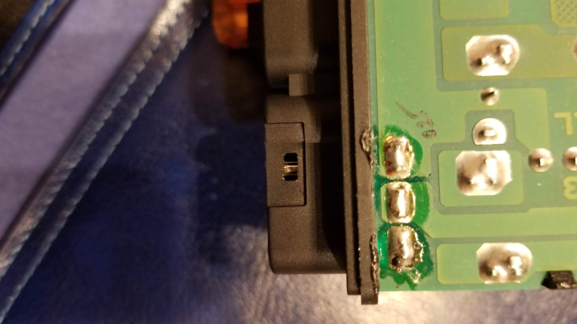

Sunday, I pulled the RCM to take a closer look - hmm, yes, halos around all of the connections. I am not the BEST at soldering, but figured I didn't have a lot to lose, and would like to be able to put the car back in the garage. Using the soldering gun I heated the pins and reflowed the solder, adding in some rosin-core stuff. (See second pic). Looks better, but not great. Did I overheat it? Reinstalled it, no crank, no start. messed with the brake lamp indicator, no difference. Hooked up the charger again, and let it sit for 30 min or so. Fired right up. But the dash lights are still lit. Maybe I do need a brake lamp switch? Guessing here, but I assumed that my RCM repair was good enough, since it did start after charging. ???

RCM - enlarged, before attempted resolder.
RCM after attempt.

Shipped to tighed1 for rehab work. Traction control relay was not engaging when tested. Fuel pump relay engaged ok and let go. Keep you all posted. Thanks!

UPDATE - Reinstalled RCM today - forgot that I had the brake switch unhooked and removed.
With the repaired RCM in place, car started right up. No dash lights on. But I'm stuck in park. Didn't think to look at gearshift indicator, I bet it's going to be a black rectangle instead of a P. Reinstalled brake switch, plugged wires back in. Still stuck in park.
Feels like progress, but not all the way back yet.
