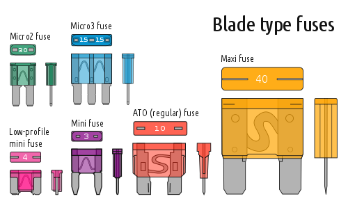

Check a fuse with it in place, both test points should read the same, either 12 or 0 volts.

In some rare cases, a fuse is in a circuit that is at a 'float' voltage, then goes to ground when active.
The 'float' voltage is unknown, as it represents the state when nothing is connected.
Usually, a fuse passes 12 volts in a car, so both little test points on top of the fuse should measure 12v, or whatever the current battery voltage is.
If you read 12v on one side of a fuse, and not on the other, then that is a blown fuse.
You can see the two test points in this picture :

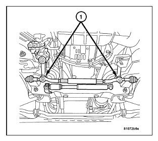

With this new alignment, you should now also change out the steering stabilizer.

Steering stabilizer? Not heard of that but i'll look into it. Thanks.
Old Jun 18, 2019 | 07:23 AM
Default Re: Eliminating air cond probs
It is the shock absorber looking thing just below the drag link in this diagram :

yeah thanks for that. Was just looking into it. Seems easy to replace. May do it soonish then.
