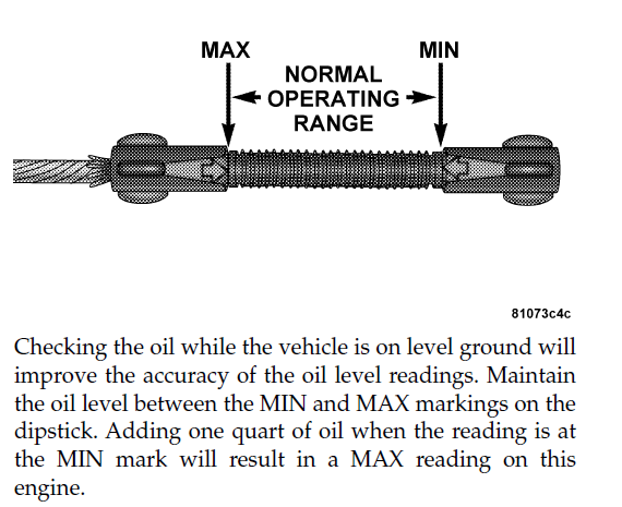

Question read oil dipstick
I have trouble reading the oil dipstick. where should the full mark be? What are the two small circles or holes ? are they the peremeters?
