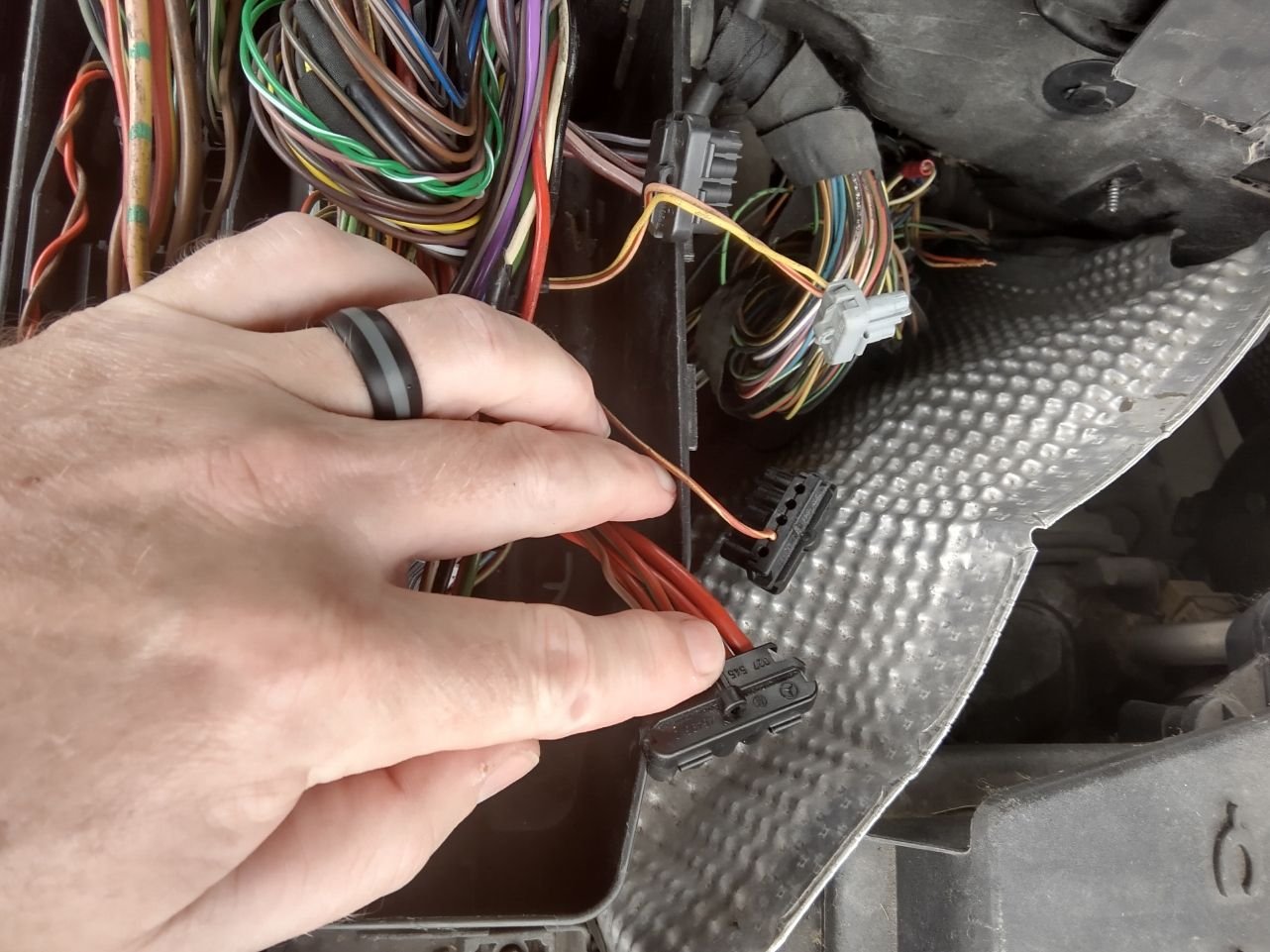

RCM has been sent for repair, in the meantime, can someone tell me how many wires are supposed to be going to this plug in the middle with one wire. I believe from looking at diagrams it is the traction control relay and think one of the two wires from the bottom photo should be going to it?
MIddle plug
wire mess

Pin 4 is Red/Yellow and feeds the Traction Control Module
Pin 5 is Red/Dark Green and feeds the automatic shift lever assembly and the automatic transmission control module. (So you have no wire there.)
Wow, that car's wiring looks like someone took it to a stereo install shop that hires pot smoking dropouts.

Any idea what the two red and yellow wires coming up from the main body harness are? Wiring diagrams have been a while for me so looking in service manual but slow

Are you 100% sure the main wiring harness for a manual vs auto are different? Many times the harness is the same, but the modules hooked up to it are different (resulting in wires that are not used if not supported within the modules attached to them). During assembly, other 'sub harnesses' are further hooked to specific models, but common harnesses within vehicles are still used (to cut down the number of part numbers and stocked parts). Sorry if this tidbit isn't helpful, but hope you get this issue solved soonest (especially since someone has been cutting into wires already).

They had to re-use some color combos, so it can be hard to determine. Red/Yellow in every case I have found, is switched 12 volts except when its SCI transmit.
For example:
A/C heater controller: Pin 1 is Rd/YL fused B+
Body Control Module: C4 pin 44 is Rd/YL fused B+
Brake Lamp Switch: Pin 2 is Rd/YL Traction System 12V output (That may be one of them, in facth its AWG no 12).
Controller ABS pin 4 - comes from the RCM's Traction Control relay output (the wire that IS connected in our cars).
Console Switch Group pin 6 - FUsed B+
Coolant Pump (SRTs) pin 1 - FUsed B+
Coolant Circulation Valve (SRTs) a number 20 wire on pin 2 and a number 18 wire also on pin 2 - Fused B+
Heated Seat Module Pin 4 - Fused B+
Instrument Cluster pin 11A - Fused B+
Key-in Ignition switch Pin 2 - Fused B+
C200 - Pin 6 has two Rd/YL wires, both at pin 6 - SCI TX
The list goes on, start on page 8W-80 "Connector Pinouts", wire size is listed, which may help you narrow it down. I suspect you may be looking at wires pulled from the harness that were in there either for an automatic or an SRT. Remember, someone got in there and messed around. I see no loose Rd/Yel wires in my SE.
Try going thru the connector pinouts for connectors ONLY in the RCM/ECU box. See if any wires are missing from connectors, if not, then you KNOW they are unused wires some asshat pulled from the harness and played with.
Got a headache yet?
THey are not different. Hell, even our Base/Limiteds have not only the wiring for the SRT's coolant pump, we even have the coolant pump relay on the pulse module.
He's gotta be chasing wires pulled from the harness by someone - who knows what they were doing, but IN CASE they pulled a wire or two from a connector, I suggested he go in and verify that all the Red/Yellow wires that are supposed to be in the connectors in there, are actually connected. If they are, then he's chasing a wiring ghost and can move on.

I think it is the secondary horn and or alarm siren as it is sitting in the trunk and wire codes look the same upon quick inspection. I think somebody probably cut it during one of its I would assume many towing sessions..
I wonder about that on Mercedes I have seen them both with and without all the connectors required. Sprinter van - no additional as each harness was custom built. No idea on these cars yet. Although I assume it was as you describe with things just left unplugged. I hope that is the case if I find heated or powered seats to swap in.

I would urge you to make sure all Red/Yellow wires that SHOULD be in the various connectors in the RCM box are actually connected. Between looking them up in the back of hte manual and checking connectors, you'd have this done in an hour. Red/Yel does SO MUCH in the car that it could be alarm wiring, but it can easily be evidence of what some dull-witted person did to get the 'no crank' fixed, doing damage in the process. I've spent 30 years troubleshooting electronics, assuming is, at this point, a potential time waster.
