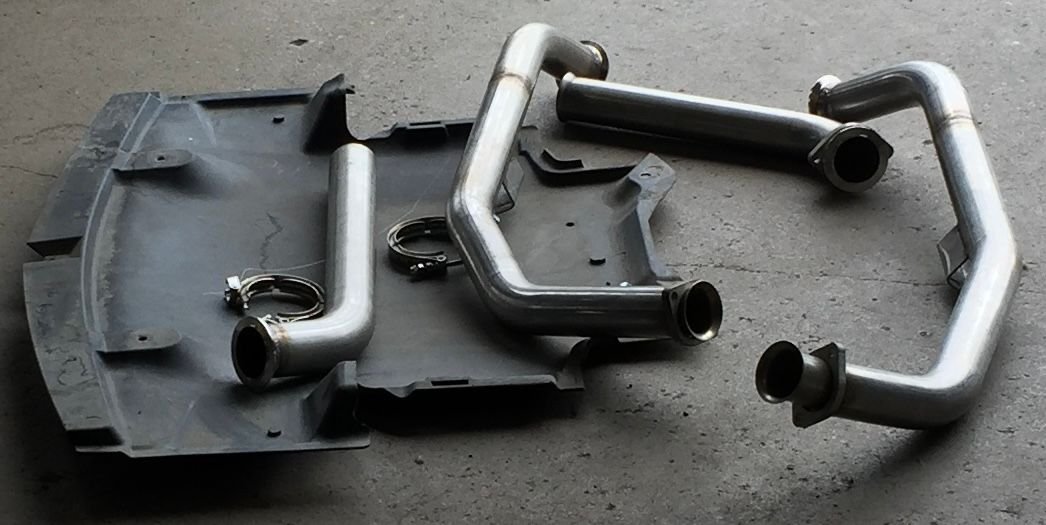

Why not just order a cat delete kit. Bolt in and look great. With less restriction, maybe an increase in acceleration
They're never going to get better so why not? Unless you have mandatory emission testing where you live, then this would be a really bad idea

Never heard of a kit and where would I get one for a Crossfire? t would be hard to find a muffler shop to do the work because of legal problems and fines if caught.

UrbanE let me know they are no longer available due to federal regulations getting involved. He suggest having them made up by someone. He did say that he was smelling gas fumes that wern't burnt by the cat. Performance was much better though.

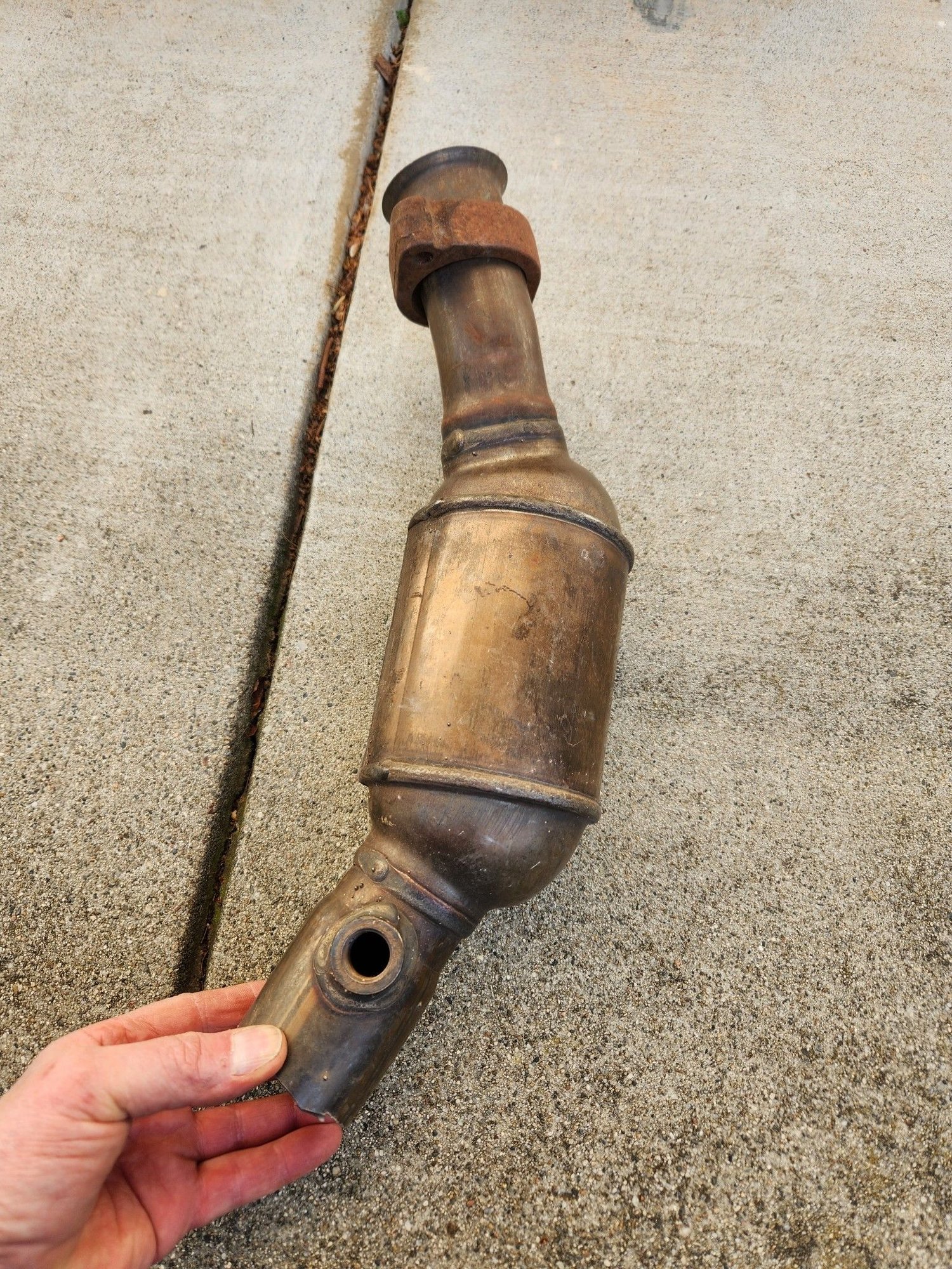

Finally found a cat converter, which came off a SLK-320, and should arrive from Calipornia today or tomorrow. It will take me a couple days after arrival to get it installed. After that's finished I'll send my SKREEM parts to MSS for a "Key Delete" mod so I never have problems with the SKREEM again.

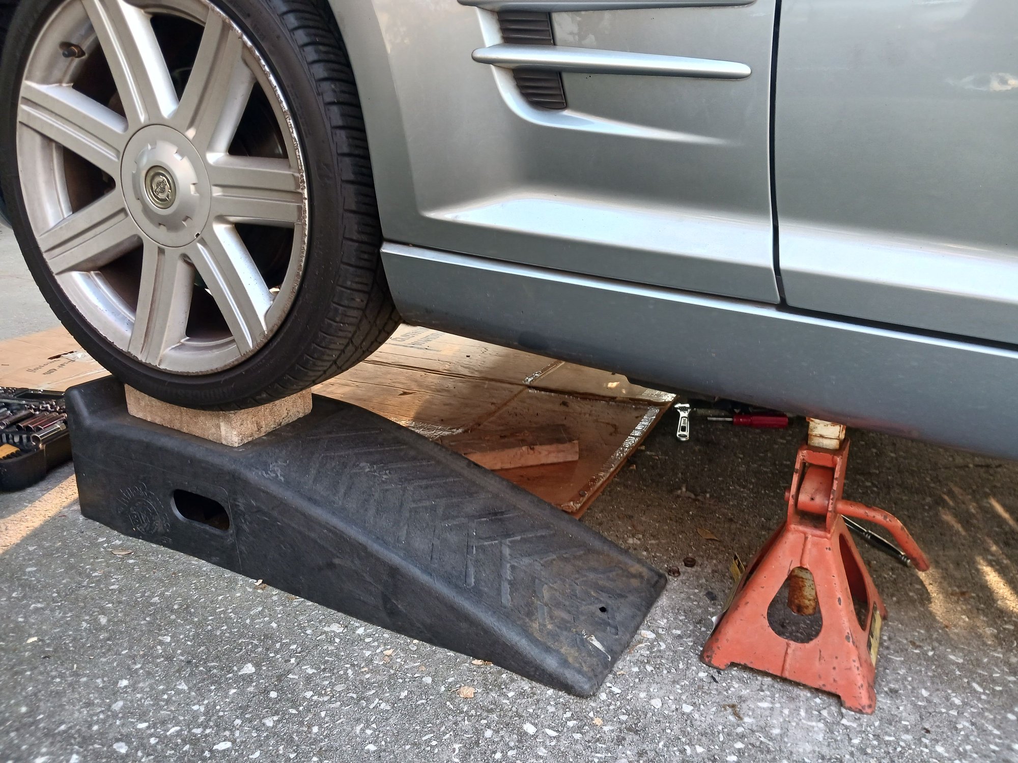

Been a long day when you don't have all the "nice to have" tools. I'm persevering day by day though! Used my ramps and paver stones to get car high enough to squeeze in from the vehicle's front. My big ole Sawzall was a bit of a squeeze to be able to cut the old cat out and had a bit of a problem in that area but finally got it off. Getting late so I'll finish it up in the morning. "Hopefully!" Bought two 2-1/2" exhaust clamps. exhaust sealer and had to make a joining coupler from a short pipe.
