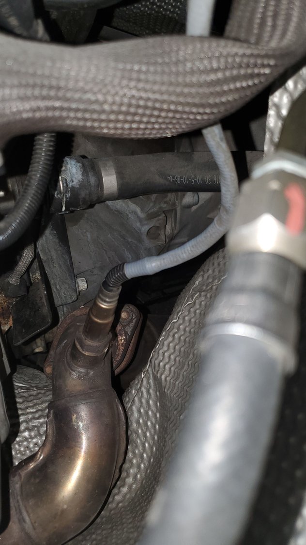

Does anyone know what this hose is called or the part number?
I tried to look up the numbers that were label on the hose and nothing is coming up on Google.
Does anyone know the name of this hose, or at least the part number

This could be it.
10 HOSE, IntermediatePiecetoHeat Exchanger
05099546AA 1 C 29 EGX,EGZ
05099549AA 1 Z 29 EGX
EGX=3.2LV6SOHC18 ValveEngine
EGZ=3.2LV6Supercharged Engine

Thank you for the support I really do appreciate you finding that part number for me, unfortunately it's discontinued does anybody know the part number for the Mercedes equivalent.
Or even something similar for Mercedes, I've been searching under heat exchanger hose, coolant to HVAC ect I'm still pulling up nothing 😔

Just to ask for a clarification, we pretty much know the drive-train is MB SLK-320/AMG32 BUT, is connecting heater/firewall hoses compatable with the SLK-320 (is the firewall & heater coil the same)? Just asking...

do you need just this connection or the hose after it as well?

I definitely would need the hose and the connector is not too sure which one of them is leaking, thank you guys again for all the help

http://www.needswings.com/coolant-ho...-cylinder-head

yes, fits both na and srt6
