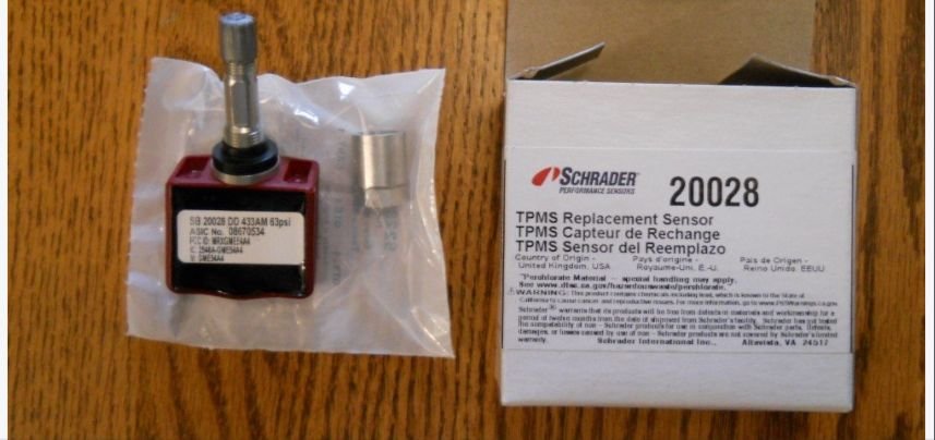

Which brand and model number of sensors did you install?
Not all of them are able to be triggered by the DRB tool? Best to know for sure before you invest more time and money

UrbanE's Avatar
Joined: Dec 2014
Posts: 1,255
Likes: 303
From: CA
Default Re: Wheel Sensors
Good point
I had assumed TPMS as it’s the most discussed
I went through several schrader 20028 sensors before I was able to land on the correct sensors that could be triggered by the magnet and recognized by the DRB Tool SCHRADER TPMS #20028
hope all works out for you.

I meant to say
I went through several different sensors before I was able to locate and install the Schrader 20028.
sorry for any confusion.
these are Not available on rock auto and the ones they list will not work with DRB
