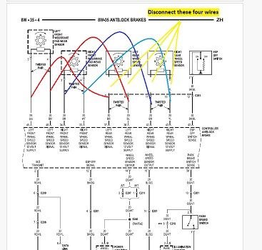

hello everyone I doing a differential swap on my 2005 NA , I adapted a super 8.8 differential and custom axles from DSS , the axles could not adapt the abs rings ! this is where i need some help? could the rear wheel sensors be wired to the front wheel sensors to fool the abs controler ? if so has anyone done this ? any ideas ? need help
I'd like to see if that would work. Try it.
1) At the CAB connector, within a foot of the connector, splice the wires to the front left wheel with the wires to the rear left wheel.
2) At the CAB connector, do the same with the wires to the front right and rear right.
3) DO NOT leave the wires running to the rear wheel connectors connected, disconnect them at C201 as shown.
I am pretty sure this is a profoundly bad idea, but I would like to see if it works. The screen shot below is fuzzy, download the service manual and go to the page indicated, you will get it.
This can't possibly work, but try it.
