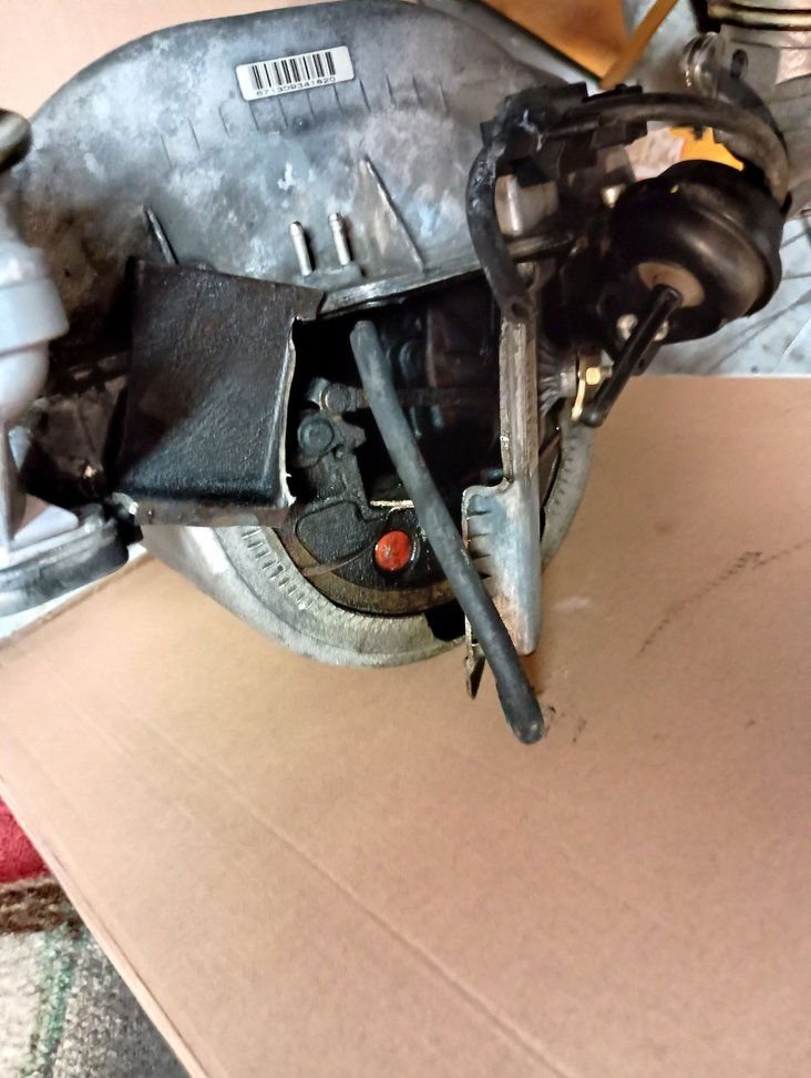

Everything put back together. No codes showing on scanner. Started car and it backfired, and the font of the intake manifold exploded. Any ideas as to why this happened?

Our injectors mist into the intake not the cylinder directly. I read you replace all the injectors with new. None the less first suspicion would be leaking fuel injector.
Considering your misfire codes you may want to replace the camshaft sensor with a new Bosch.
How long did the engine run before the backfire destroyed the intake?
Any other codes besides misfires?
