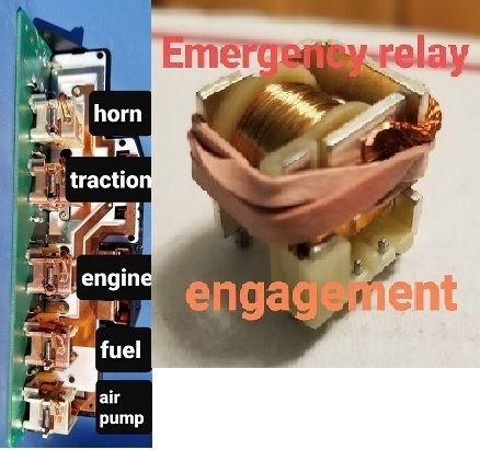

Check that two of the middle relays remain closed with the key in the ON position. If the Engine relay isn't closing, manually close the relay or wrap a rubber band around it to see if she starts.
If it does ya might wanta send the RCM to me to get it rebuilt.
