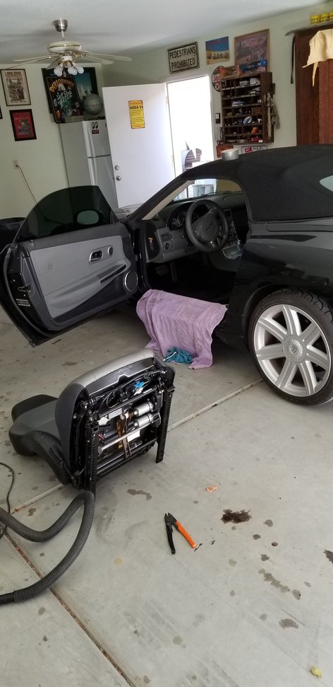

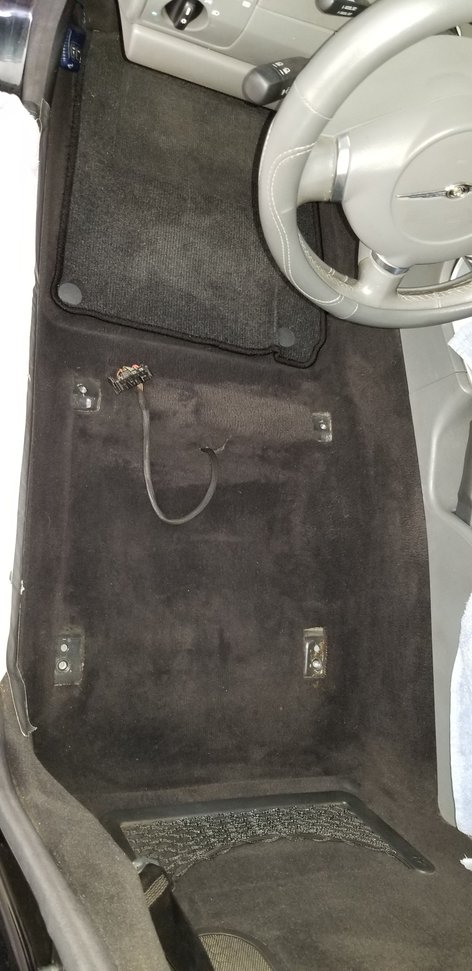

Performed this upgrade while swaping leather out.
It was 50 bucks plus 25 shipping for slk track on Ebay.
I had already swapped seat bottom out on drivers side so knew the seat assembly well enough to do it all in same afternoon.
Did the bottoms of both seats, then did top of drivers later on.
Convertibles collect tree debris as a price they pay for shade. Good time to vac and steam clean carpet. This mess came out looking like new.
Passenger side seat out and cleaning begins
the pin
old skinz gotta go... Amazing how much better new leather feels to sit on.
Steam them rugs while the seats out. Yes clean new smelling carpet is nice bonus to these swaps.

I just got 2 seats from a guy. The driver's one worked Great. The passenger functions great but oddly it sits like 2 inches outboard.
So it's too close to the door and when. You lower the seat it crams into the carpeted sidewall. I have removed it and set it next to the factory seat. Any ideas?
Too close to side wall
Passenger side has almost a 2
Passenger side has almost a 2" gap between center console. The whole seat is shifted outboard. I have no idea why. The seats are dated 2004 made at lear. My stock seat says 2005. This is an 8 way passenger so maybe it's the wrong year slk?
