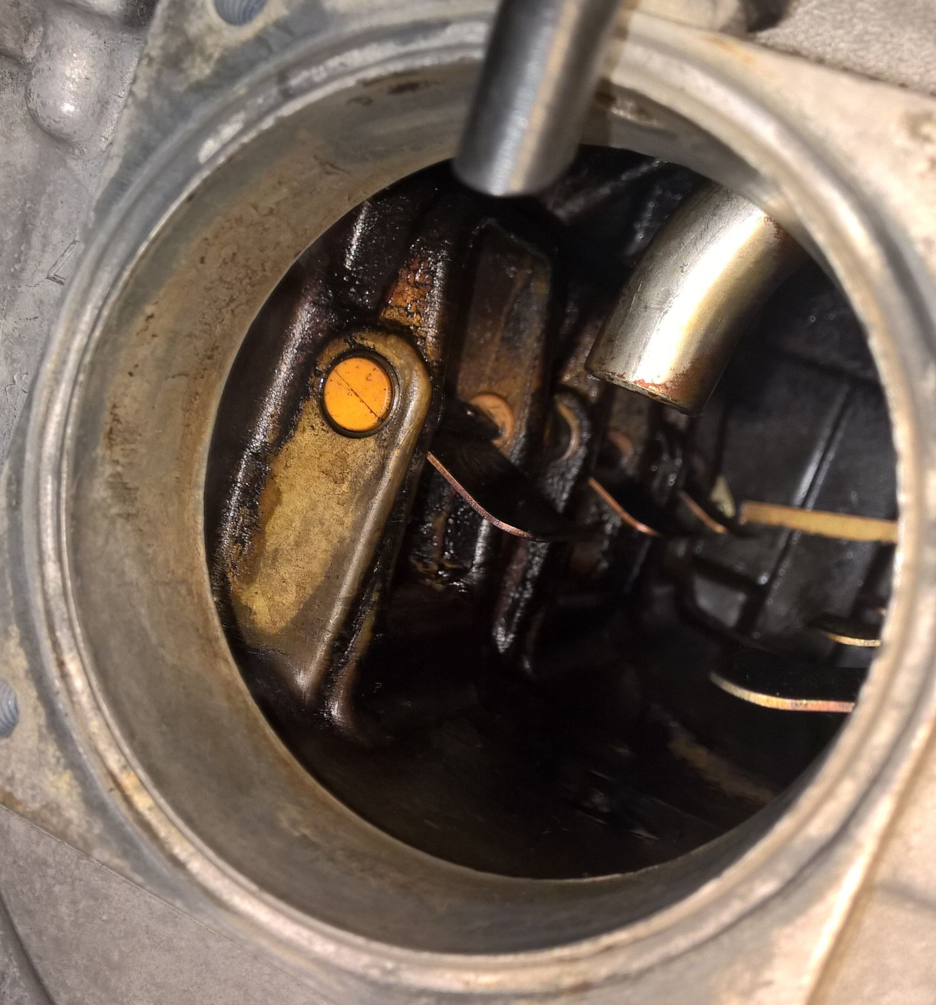

So I recently upgraded the throttle body on my 2005 N/A to the 74mm. I took a picture of what it looked like inside the engine behind the TB. It wasn't pretty:
I am in the military so I perform all of my car work at a "auto hobby shop" on base. They have a bunch of old school mechanics there that are hired to help people with projects and give advice. One of the Mercedes guys saw this picture and told me about a safe way to fix it. All you will need is a bottle of Sea Foam purchased from Autozone or equivalent. This takes about 40 minutes total with most of it being waiting. I recommend doing it in an open parking lot as things will get pretty smoky.

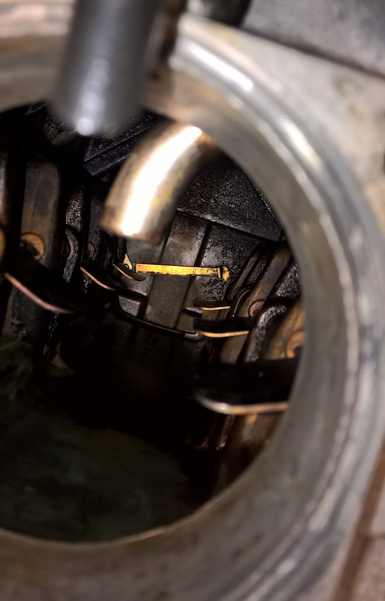

2. Disconnect the hose that feeds directly into the air intake while the car is running. Immediately plug the end of the hose with your thumb or your car will stall out! Here is a picture of what I am talking about:
Note: there is a lot of suction on this hose. It will not pull your skin off or anything, but it is not comfortable to cover with your thumb for extended periods of time
3. Create a small slit between your thumb and the end of the hose by moving your thumb down a little bit. Really just the slightest bit of space for air to get through.
4. While there is a little bit of space allowing air in, start to pour some Sea Foam into that slit (see the red arrow in the picture above). Pour very slowly. The engine will struggle a bit as you let air in past your thumb. As you hear the engine struggle, cover the hole completely for a second or two to prevent it from stalling. Once it sounds normal, reopen the slit and pour a little more.
