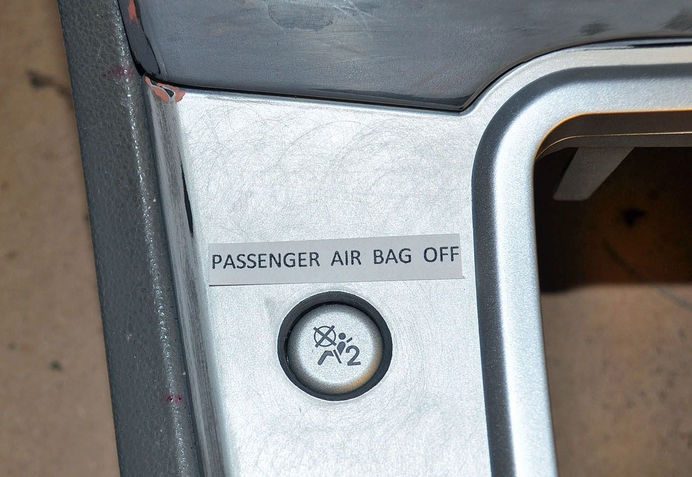

I started this project in November 2017 and I am still far from finished, I have to put another coat of U/coat on the HU bezel as it needed some filling, U/coat the gear shift bezel, put on the finish coat to both, add the passenger airbag transfer to the gear shift bezel and add a clear coat to both.
The transfer added to a paint chip I made.

Nice job on the transfer Dave, was it difficult to make?
Old Jul 22, 2020 | 05:11 PM
  #126 (permalink)
Likes: 648
Default Re: Fitting a double DIN radio

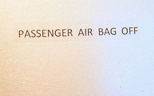

Laser printed on clear transfer paper, that particular transfer rubbed off because I was playing around to see how it could be moved into place to line it up properly so the glue was almost gone. Another one stayed on just fine, they will need at least one coat of clear coat.
Transfers done on colour printers need to be clear coated before wetting to prevent the ink running.
The edges of the transfer ideally need to cut with the transfer on the bed of the guillotine as the other cut edge gets slightly delaminated. The delaminated edge was very slight but was visible, the transfer film is .0008 thick so under a clear coat the edge may not be visible. The use of a pair of sharp scissors might be best, the same rule applying.
The transfer still on the backing paper laid on the gear shift bezel. A dry run so to speak.

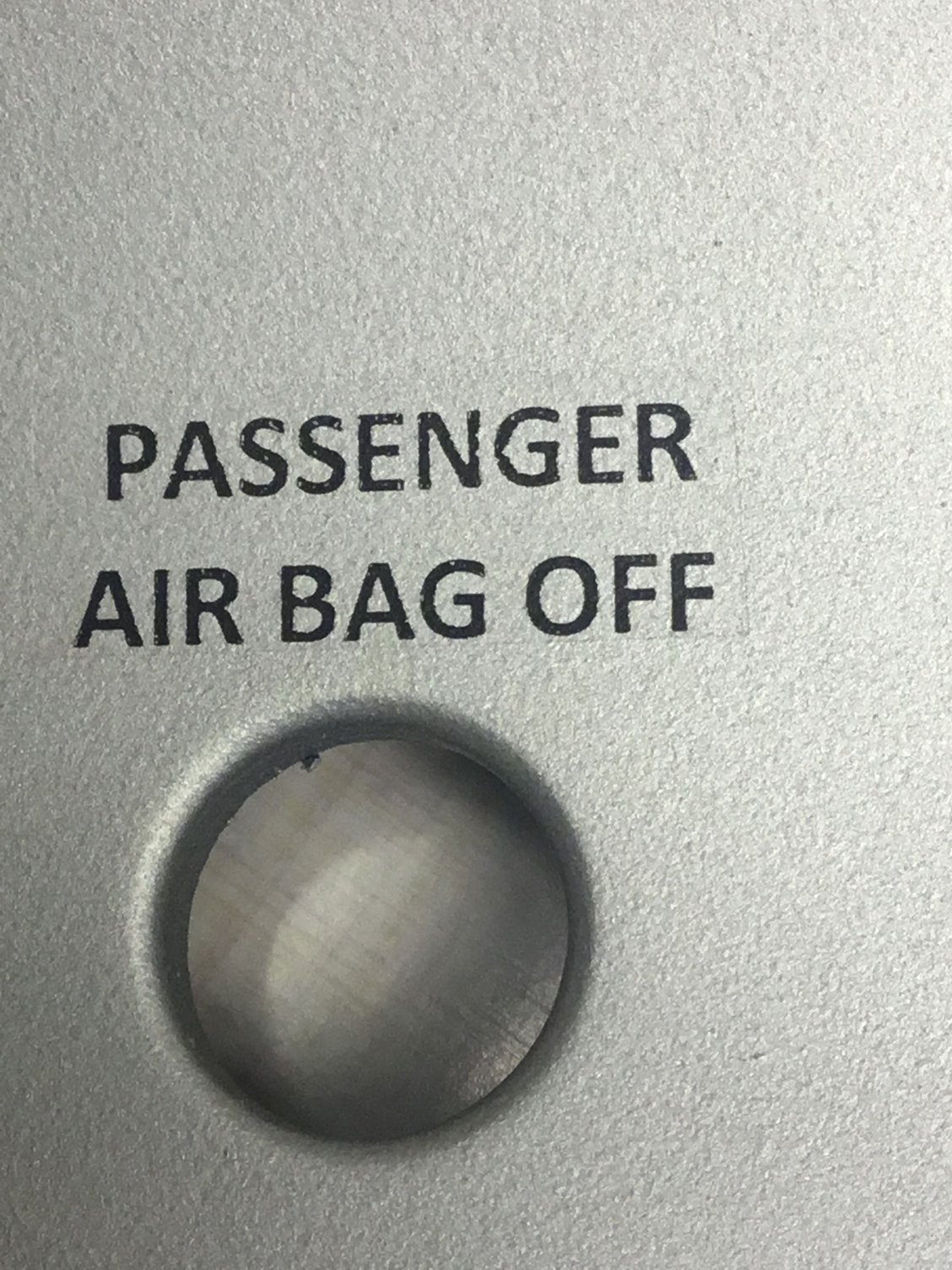

I gave up looking for a perfect paint match. So I used DupliColor PS2 and DupliColor matte top coat. I painted all the plastic parts from the upper vent to the bulkhead. I even added transfers printed on my laser jet printer to replace the ones lost.

Thank you, I started this project in November 2017 with the Mk1. version which had the buttons in the coffee cup holder bezel.
The Mk1 version shown fitted and ready for painting, which never got finished. It was undercoated later before I changed to the design of the one-piece bezel.
This version is now fitted in bluecoupe’s NA.
The one piece bezel was harder to do and Covid got in the way of finding the correct paint and I slowed down. I decided I was not going to get a great colour match and decided to paint all the console pieces with the same rattle can colour, DupliColor PS2. I also used DupliColor, adhesion promoter, undercoat and matte clear coat. The rectangular piece of trim around the gear shifter is the OEM colour, I never modified any of the original parts, they are all kept aside with the OEM Nav radio. They wanted too much for the rectangular part on eBay ($60 to $80 plus shipping) so I am waiting for something reasonably priced.
I made the three transfers on my laser printer, they were then covered in at least two layers of a matte clear coat and lightly rubbed down.
All in all I am satisfied with it, maybe I will touch up the little faults I can see, maybe not.
