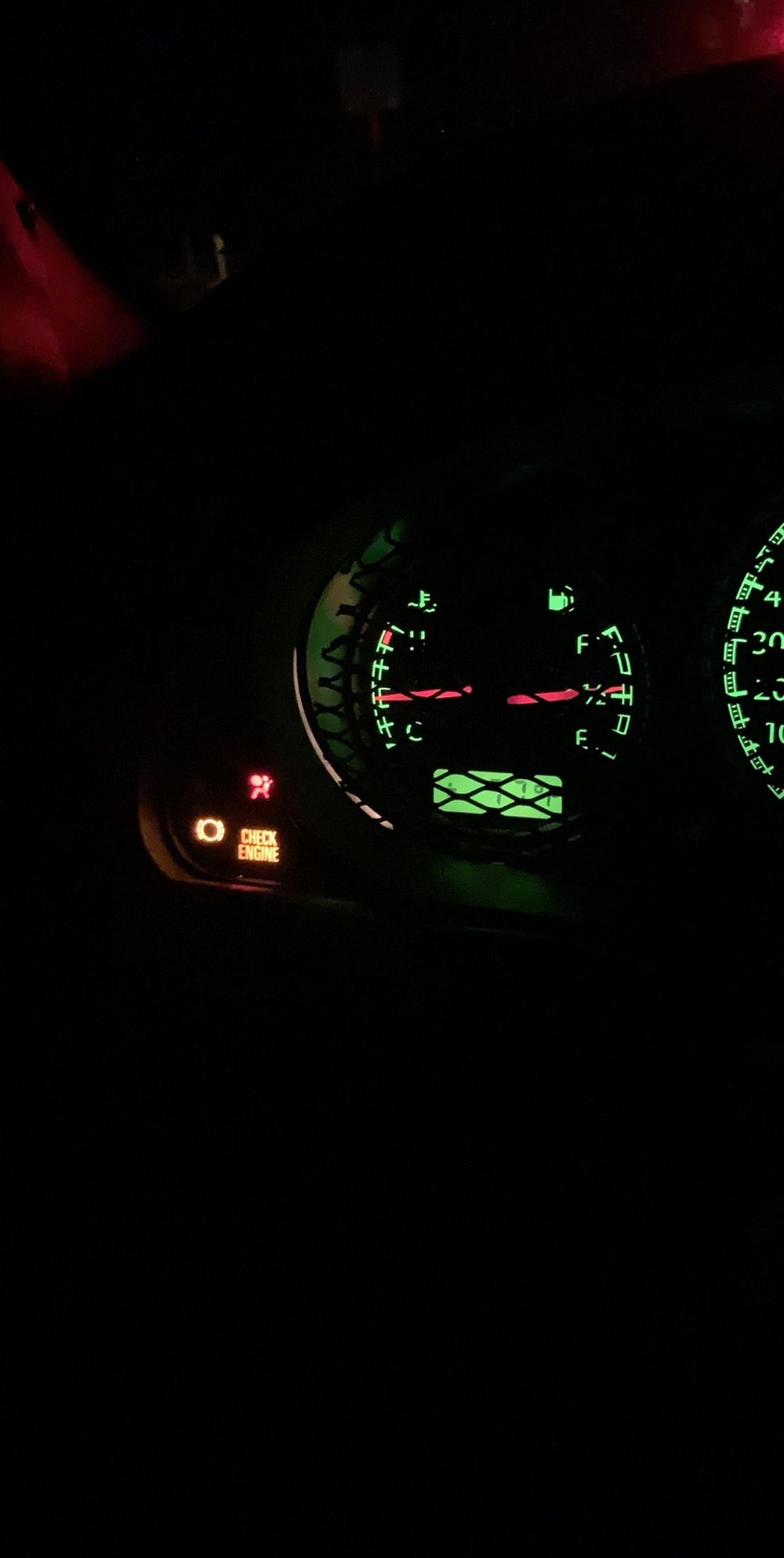

i let the car sit all afternoon and decided to head out when it got dark. 9-10 ish. start up was fine and first redlight i come across, i get lights back on. i am so concerned. what do i do or what did i do wrong it tries to go into limp mode but actually comes out of first gear. i stopped driving it to not force anything. but yes i got the bolt out and replaced it thank you .
