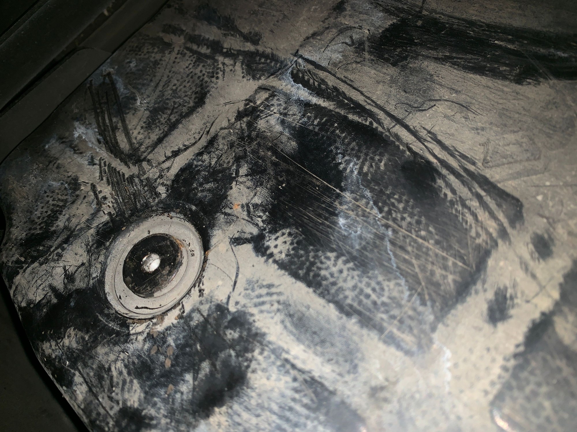

i've noted all instructions 📝. thank you guys. BUT! came across my first problem. STRIPPED DRAIN BOLT FML
last owner couldn't have made it any worse for me. i have no idea how i'll get this out

You can take off the pan without removing the drain bolt. I've changed the fluid & filter on lots of automatics which had no drain plug at all. Try and loosen the pan bolts so that the fluid will drain from one of the 4 corners. Dollars to donuts you can find a helpful video on Youtube.
