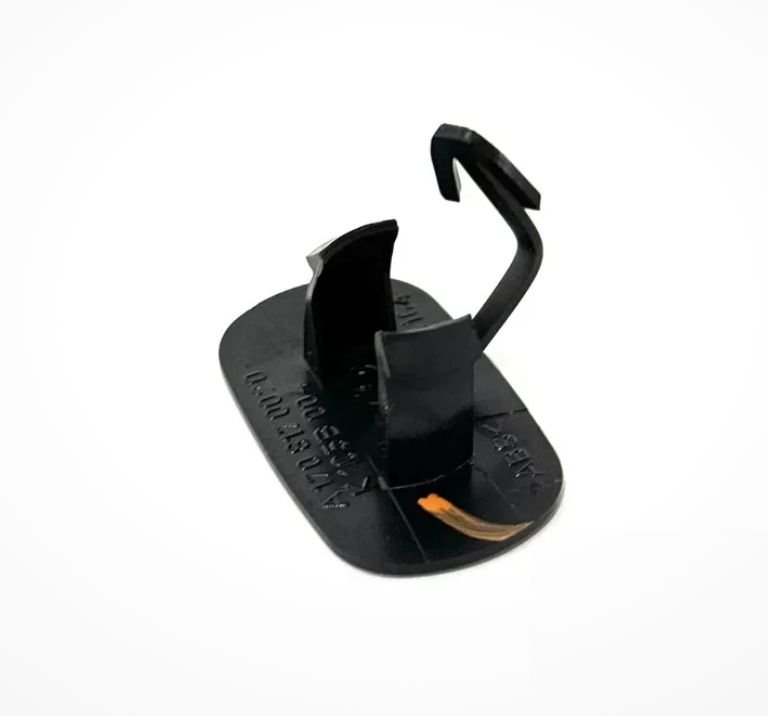

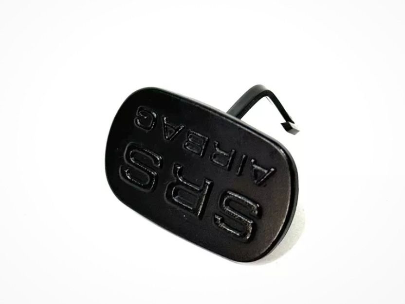

Did you get the one behind the SRS logo plastic
use a trim tool to pry it out. It has a plastic retainer that’s about 3/4” long.
Try not to rip it out.
