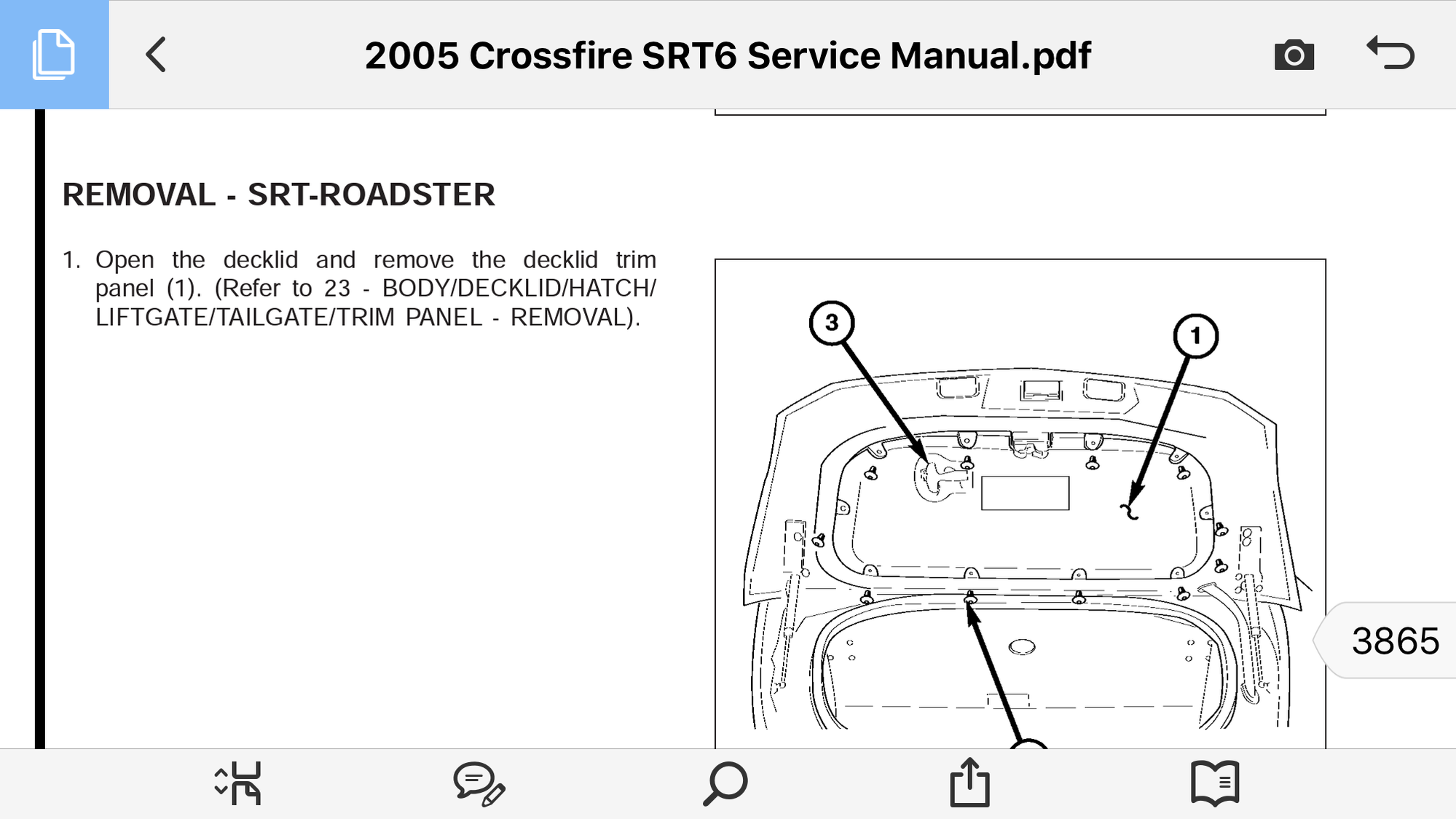

Super simple to change
plug and play
download a copy of the service manual, be mindful of the torque.
Disconnect the batttery before you unplug anything
usually a few of them available on eBay.
Look for these pages in the manual for the NA wing. This one is from the SRT section.
