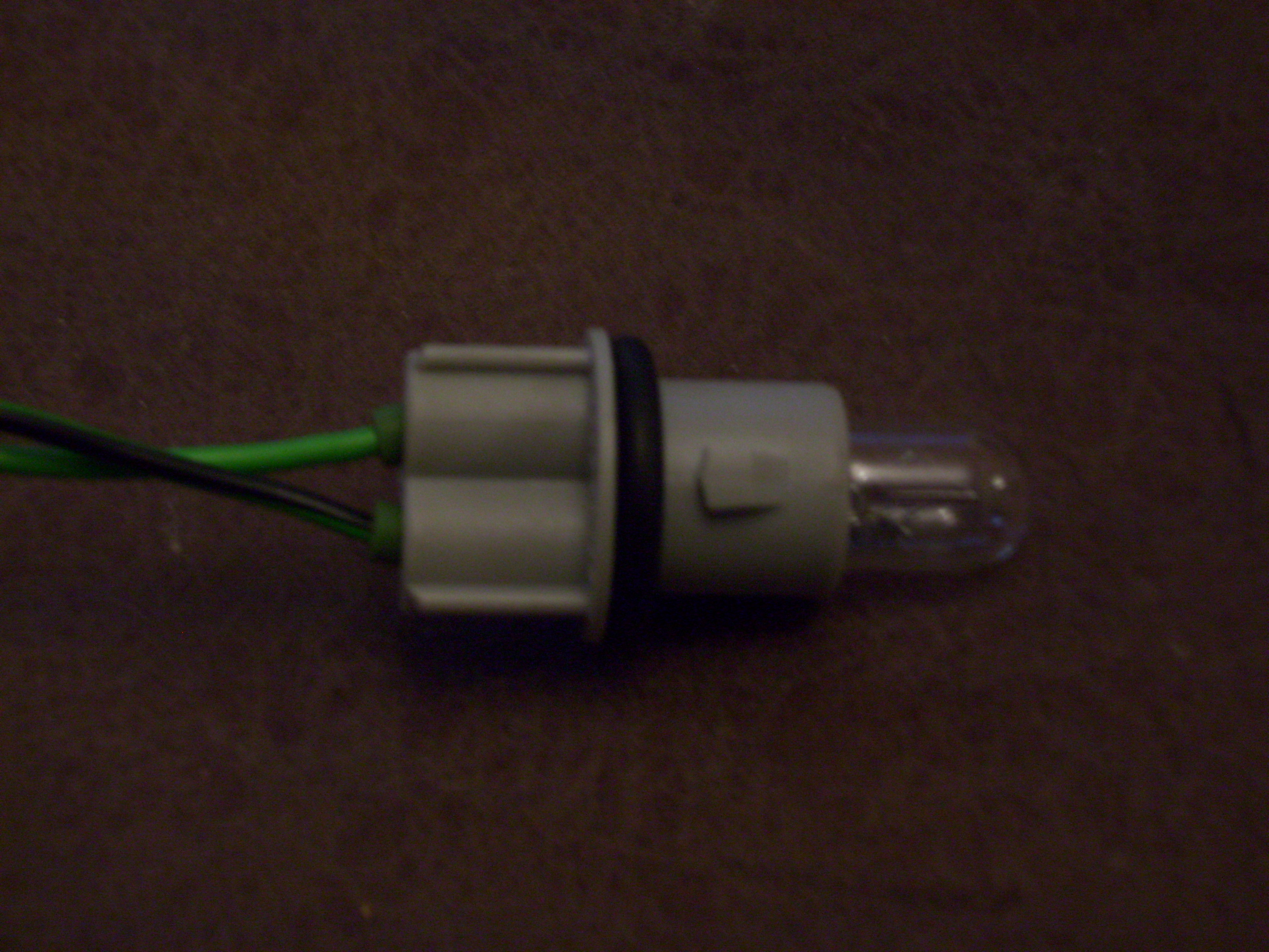

you wouldnt happen to know the part number for the bulb holder from MB would you? ta
Let see if I can dig this out - I bought a pair of these to illuminate some red rear markers which I recently got from the states. These bulb holders are used on various different MB models. Give me a few hours

MB Bulb Holder Part PA66 GF30 used on various models for marker lights and side lights.
