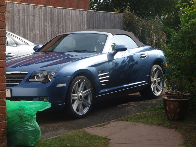

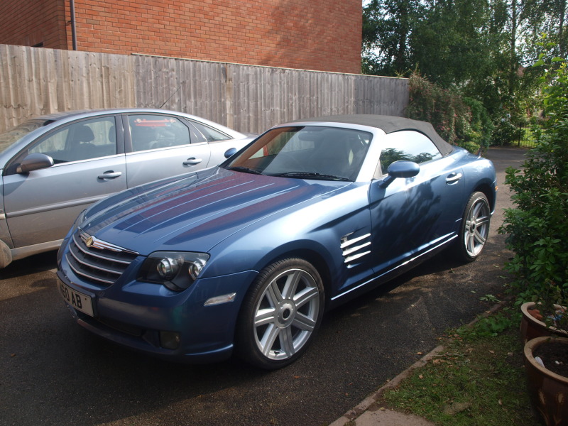

well i just picked her up from the paint shop and to say im pleased is an understatement got her back looking better than new.
up loaded some pics to show you what i had done and you wouldnt believe how cheap it was, show you the pics then tell you the price at the bottom. try and guess how much as you look at pics
Picture 1 and 2 the repaired door and wing after some idiot hit it,

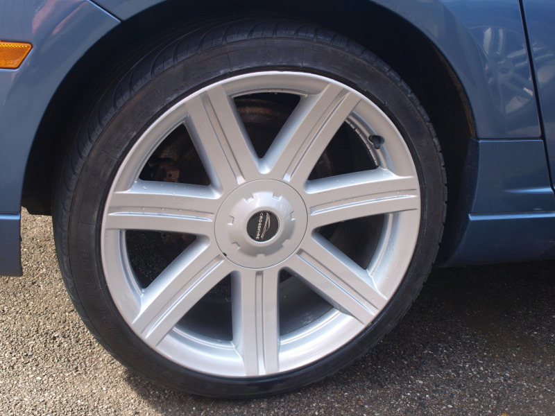

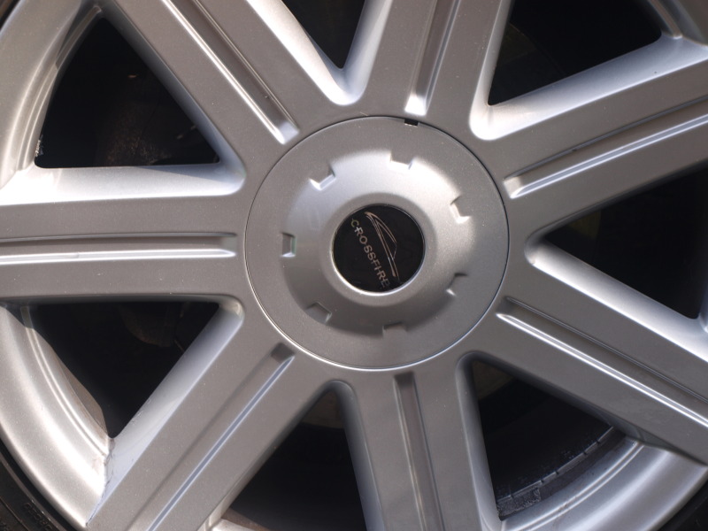

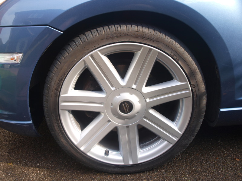

next 2 pics of the fully refurbished wheels

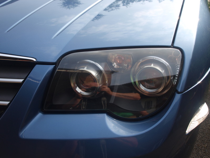

and finally the refubushished head lights

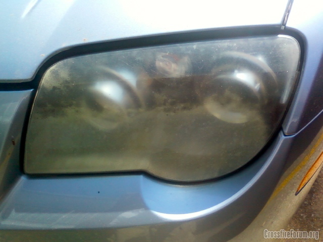

lights before refurb

all this for the Princley sum of £310 what a bargain

I had my headlamps done recently now I want it to be dark so I can test them out.
Car looks great i must say

haha was think that exact same thing on my way home lol, he only charged £30 to do the lights,
and thanks i'm pleased with it.

Dave. So they took them out. Stripped them down. Painted them black. Refitted them. Set the beam all for £30.00 ?

No mate they not black they are clear he does them in the car its only the front cover but they look like new

Good job. Interested to know how he does that?

All he has done is polish the Plastic lens.
All plastic headlamps go like this! I did the same on my MX5 a few weeks ago. You simply start with some 1200 Grit Wet and Dry and the end with 2000 Grip W & D and the polish them back, I usually end using some G10 farecla. I've been trying to buy a Roadster over the last couple of weeks and everyone one I've looked at had this, it's a good bargaining tool if the owner doesn't know how to rectify it

yes mate this is pretty much what he did except he finishes it off with 2 coats of clear lacquer
