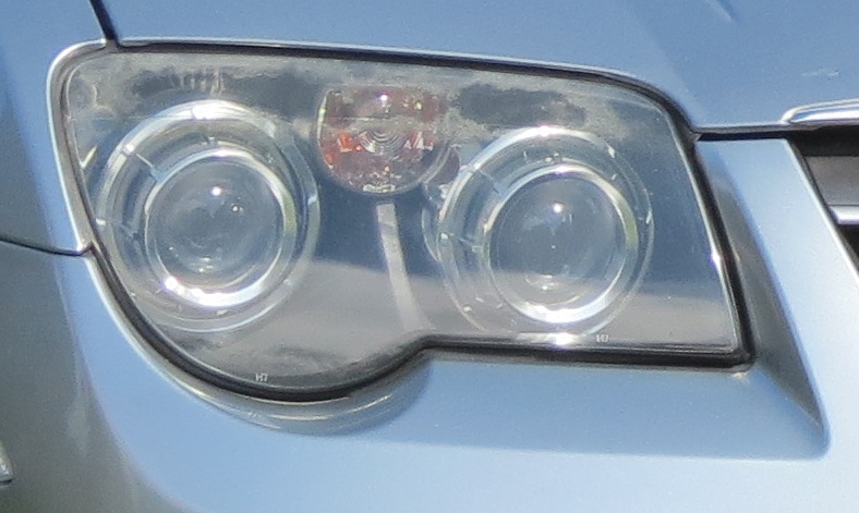

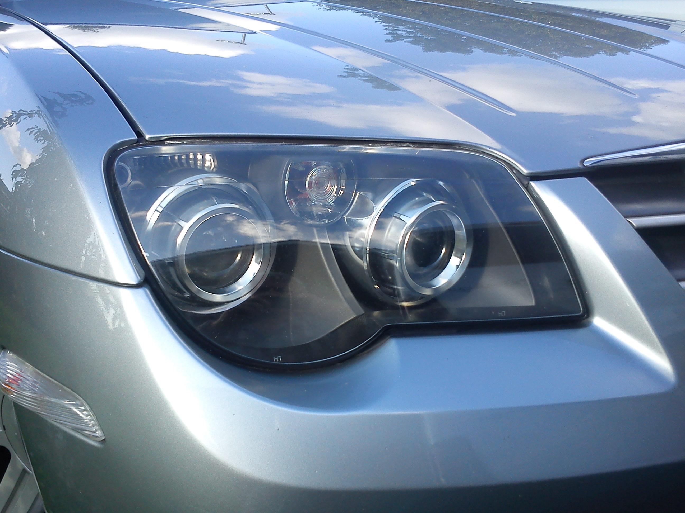

Talking of jobs been putting off! Hard work & Meguiar's Plast rx
Attached Thumbnails Completed a job I'd been putting off...-before.jpg   Completed a job I'd been putting off...-after.jpg
You can certainly see the benefits of your labour there, good job

Thanks Dal - I must admit to being surprised just how much difference it made - it did look as though it was on the inside of the lamp - if this helps others I will be happy
