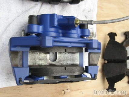

I broke mine down when I installed my pads/brakelines/rotors and painted them with high heat cermaic paint. - If your going to keep them black - why bother or pay the extra $$

I did the same thing, just got back from the dragon and they look spotless.......got the paint kit from R1

what preperation is involved when taking them apart,painting them, and them re-installing them. also how long does it take from start to finish

actually the kit comes with a cleaner, but I put them in the parts washer, you can do this in a pan or bucket w/ some cleaner...but careful around the rubber parts, use the provided cleaner...make sure they are dry...mix the paint and the activator...comes w/ a small brush...paint away...you will need to paint them at least 2 times, I did 3...doesn't look like much paint, but I had paint left over after painting all 4...they look grt and the Dragon was a wook-out...

I completely disassembled my calipers and powder coated them. The first one I coated the powder didn't take to the thick protective coating that comes on the caliper. So I roughed up the coating with a wire wheel and the powder coating stuck this time. I masked off the areas I didn't want coated with aluminum foil. The factory rubber coating on the calipers is VERY heat resistant, no smoking, burning while I cured the paint @ 400 degrees for 15 mins.
Disassembly is easy, remove the bleeder valve, use compressed air to blow the pistons out (be careful!).
Assembly was a bit of a pain getting the dust boot to go on while trying to get the piston back in.
Don't forget to bleed the brakes when you are done!
If I had to do it all over again I think I would have bought the caliper paint kit.

the only difference with the paint kit than what tighed 1 explained is you really don't have to even take them off...mine were off because I was adding metal lines and SBF, so I had to bleed the lines anyway...I think that is what you are doing as well, so since they are off, it is easier to clean and paint them...I went silver, but they have all the colors you could want...and they look factory or better...they will have to set 24 hrs before use, I did mine in the evening, driving it next evening..
