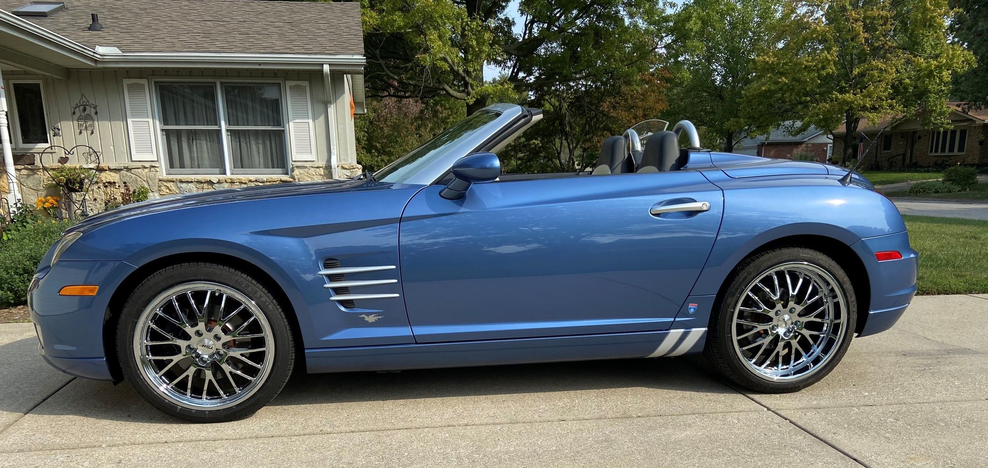

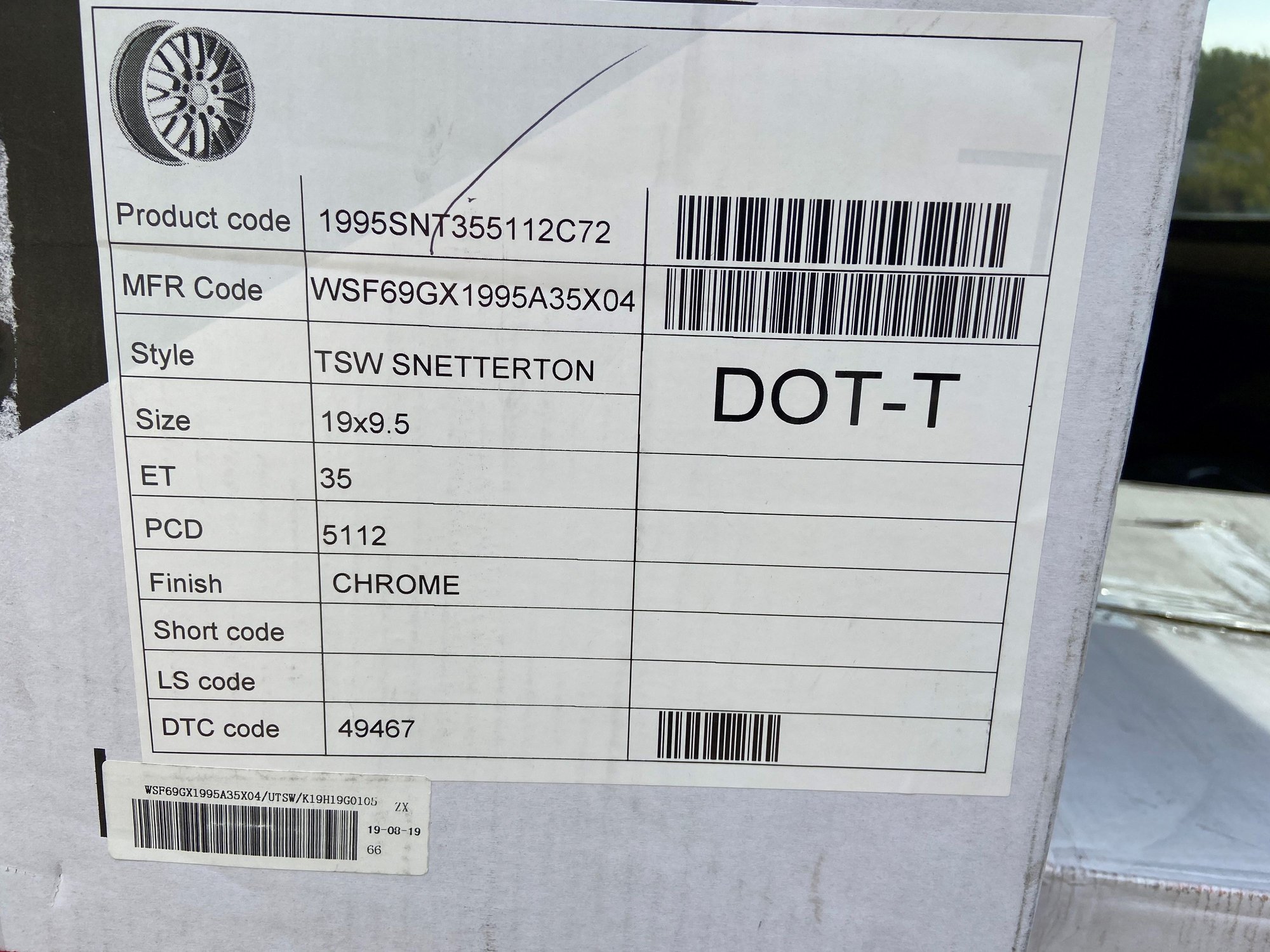

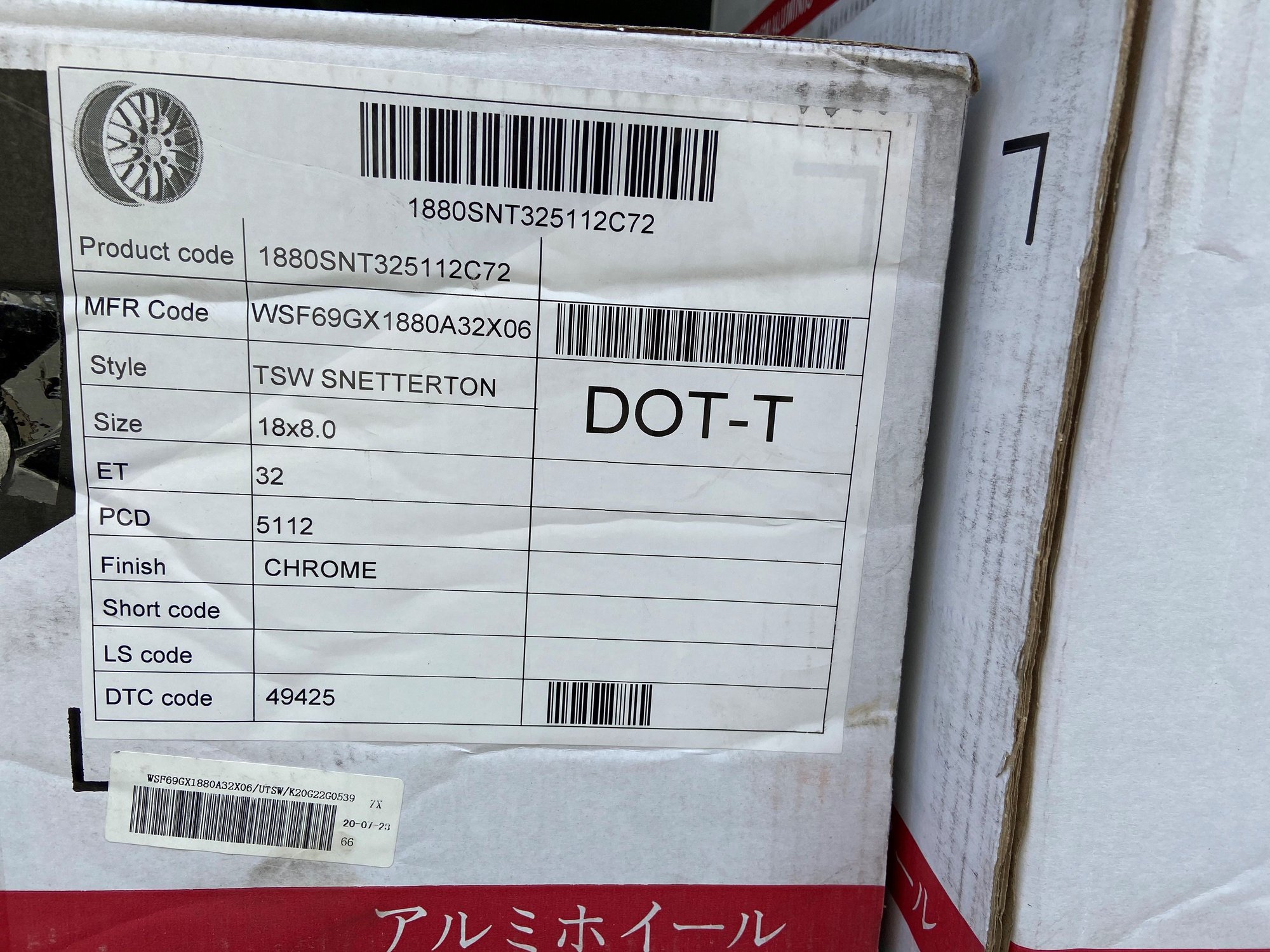

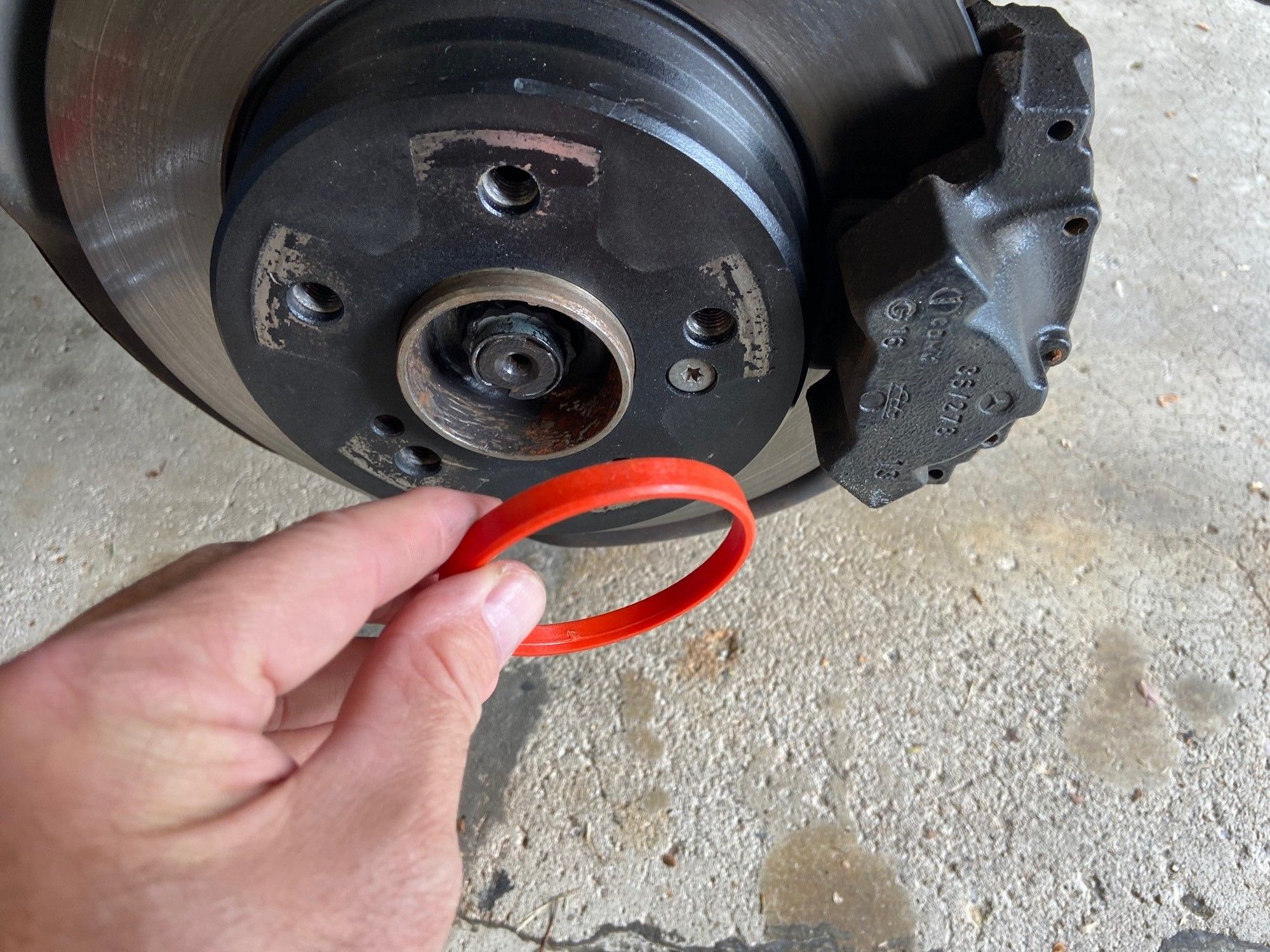

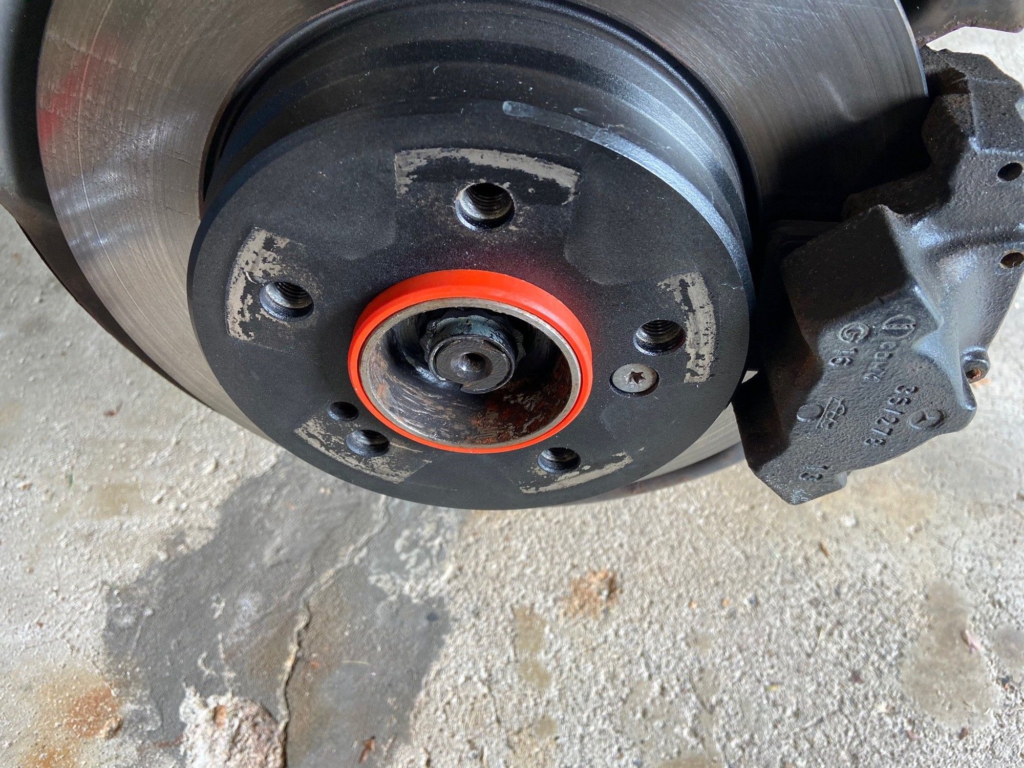

I put these on my car last fall. I also added 15mm spacers to the rear. This photo however is before I added the rear spacers. Don't forget to have them install the "centering rings/spacers" These will ensure your aftermarket wheels will fit snug to the hub.

I will admit, the TSW Snetterton wheel looks really good on the Crossfire!

Those look great! I agree they are a good option for the Crossfire.

I absolutely agree those wheels look great on Crossfires!

Where did you source these from? Having a hard time finding them in stock.
Thanks and they look amazing!!!
