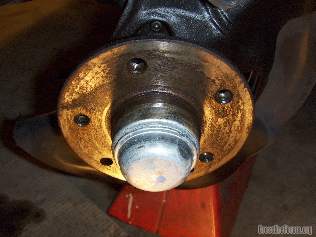

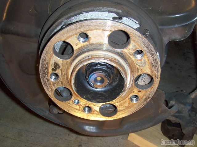

I've only had my SRT-6 for a few weeks, and already I'm sick of cleaning brake dust from the wheels, so today I ordered some Rotex Gold pads for the front and rear.
In the meantime, tonight I decided to pull the rotors and have them turned just to remove any glazing and reduce the chance of squealing. Even with only 5 years and 10k miles on the car, I was surprised at the amount of rust and corrosion in the rotor hub area. In fact, the driver's front rotor took a lot of persuasion to come off in the form of a rubber mallet, PB Blaster, moderate heat, and finally a prybar.
In light of this, it may not be a bad idea for owners to pull their rotors now and clean up the surfaces with a wire wheel, and then coat the rotor flange and hub surfaces with Anti-Seize. When the time comes for new rotors, you may be glad you did. For those of us in wet or northern climates it could make a big difference and reduce labor time significantly. Just a thought.
Driver's Side Front Hub....
Driver's Side Rear Hub....

its common, especially in wet/snowy climates. They really do nothing corrosion resistance from the factory.
We do exactly what you described with the anti seize and wire wheel, it helps alot but it doesnt prevent it 100%.
On my 240 I had my hubs coated to prevent it, since I do alot of installation and removal or parts. We had a severe problem with our c6 z06, and it never sees rain. Just the water from washings caused the hub/brake rotor mating area to rust up.

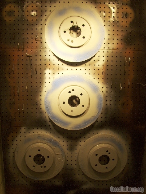

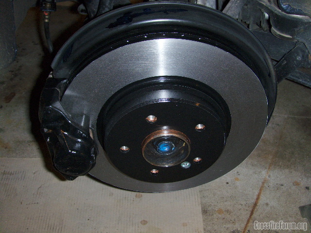

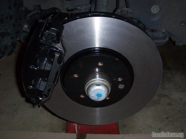

Update: The rotors have been bead blasted, turned, painted, and remounted. The calipers were painted and are mounted with new Rotex Gold pads. I almost have it back on the road......
Rotors in paint booth after primer
Driver side front rotor and caliper remounted
Passenger side rear rotor and caliper remounted

Just for the record, the brown color that is shown in the final pictures isn't rust, it's copper Anti-Seize. The rotors and hubs are now rust free and will hopefully stay that way.
