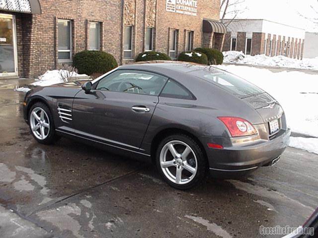

would these wheels fit on our cars??
17" Gunmetal Fits Mercedes benz AMG wheels CLK C E S - eBay (item 380293854132 end time Dec-01-10 10:40:42 PST)
i saw one of the members out on slk320 sport 17" all around with blizzak for winer drive and it looked nice
here is a picture http://www.crossfireforum.org/galler...46MVC-010F.JPG
