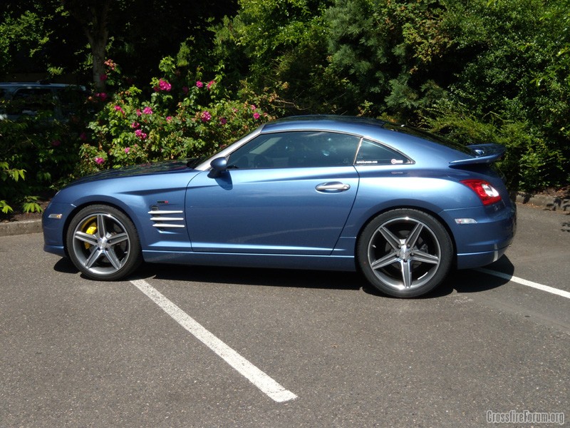

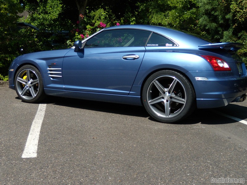

Here are new pics after a wash and swapping the center caps.....ENJOY more pics in gallery.

Very nice Mike. The rear looks beefy!

Looks great the ride height looks perfect to me ...

Are the offsets 32mm front and rear?

I still can't get over how GOOD that looks.
Now, the real question... when are you painting your rear calipers yellow to match?
Superb fitment on the wheels.

Yes, the offset is 32 on both ends.... this let me clear the C32 calipers in front without spacers and remove the spacers in back and still have the wheels near the outside of the fenders....
Yeah, I do need to find a yellow paint kit and do the rears and re-do the fronts... I did the fronts with engine spray paint before I installed them when I bought them.... I will probably pull them all off again when I do the rears...
I was very please to see how nicely my front rotors are wearing... these are used C32 rotors that came with the calipers and I had them re-surfaced before installing.....
