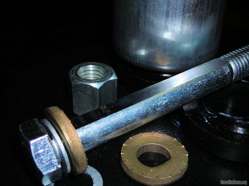

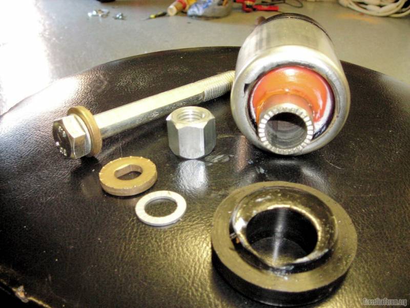

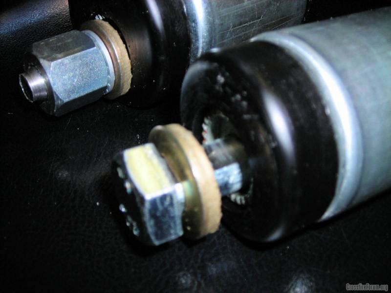

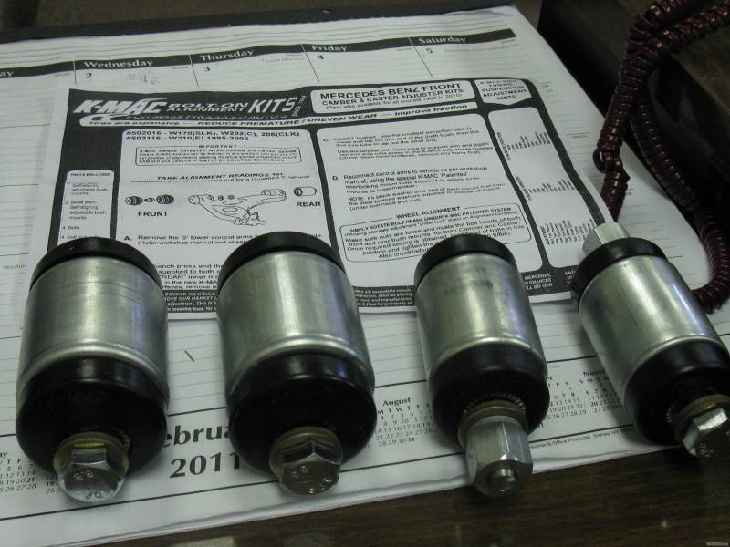

Arrived Today

Howard, I see how they will alter the adjustments with the off-set bushings. Must they be pressed in a certain position? And once pressed in the control arm, can they be rotated for adjustments?
James
Old Nov 23, 2011 | 02:56 PM
hcarter's Avatar
Posts: 2,358
From: Kingsport Tn.
Default Re: Ordered K-MAC
That is correct James , a lot of adjustment either way positive or negative.. , I'm looking forward to getting them installed .
Old Nov 23, 2011 | 03:11 PM
Posts: 10,458
Likes: 157
I just don't understand how they "adjust" or rotate once pressed into the control arm.
Old Nov 23, 2011 | 03:15 PM
hcarter's Avatar
Posts: 2,358
From: Kingsport Tn.
I haven't really looked them over very close but later tonight I will try to take some detailed pics with the bolts apart and laid out..maybe I will better understand too..
Old Nov 23, 2011 | 03:19 PM
hcarter's Avatar
Posts: 2,358
From: Kingsport Tn.
James I think the bushing actually rotates around the bolt and then there is a splined washer on the bushing that locks by using the washers under the nut that are splined also if that makes sense .

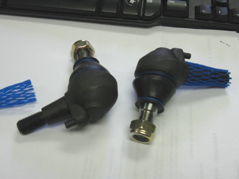

Update , Got the last of the parts today for the front end rebuild . Lower Ball Joints , Koni Sport Shocks , New Steering Stabilizer/Damper , and K-mac Adjustable Bushings . already replaced upper control arms when I cut the springs. Joints come in this morning. Time to go to work...
