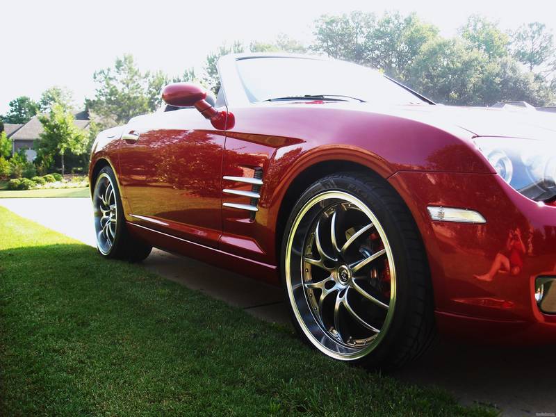

Max I must be confused has your car been lowered yet ? if not you may just want to install the springs with the pads that are on the car ,that may get you where you want..

Howard-my bad. That picture is from 2008, right after I got new tires and wheels. It still looks exactly that height. And your answer is pretty much what I was thinking. Any other thoughts?

Sorry for the late reply Max , after seeing the picture you should keep the pads that are on the car and with the spring drop you should be looking and riding great...
