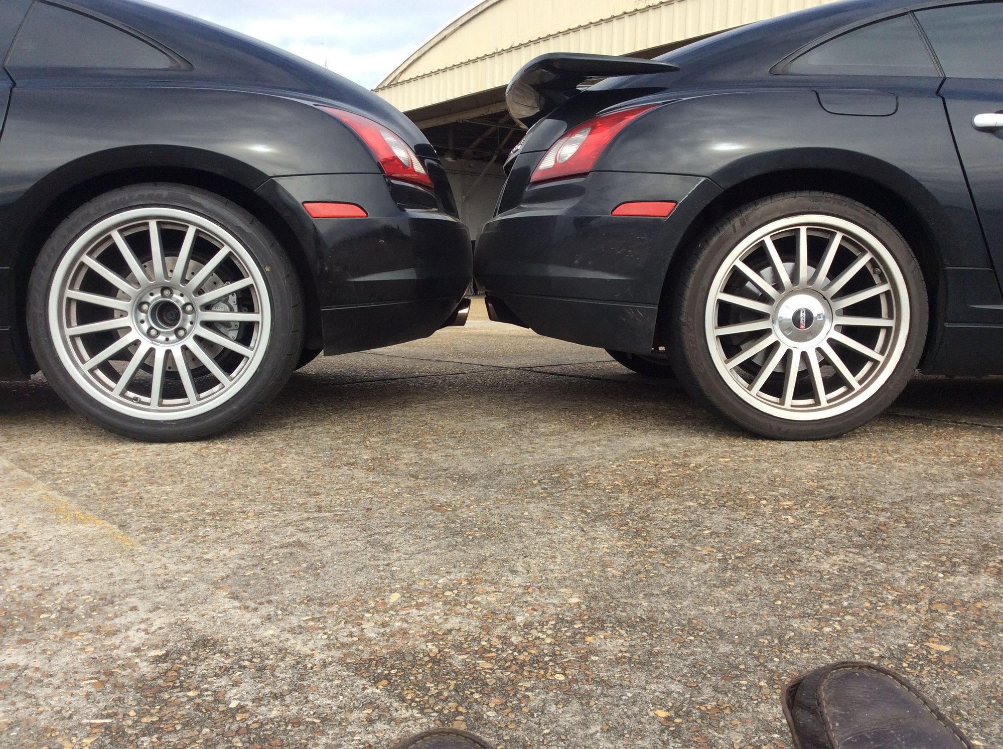

Stock SRT and NA with 300mm disk.
Old and new!

Nice write up, short and concise.
It might be better if you stated this is for mod to an NA. Your old an new pic shows just the size difference, as it really shows an OEM and an SRT disk.

Correct, this was done to a 2005 NA coupe, along with the 345mm front mod.
