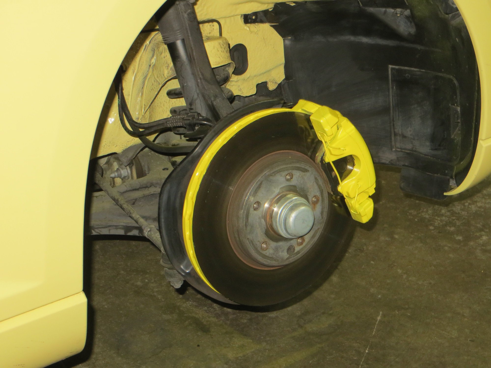

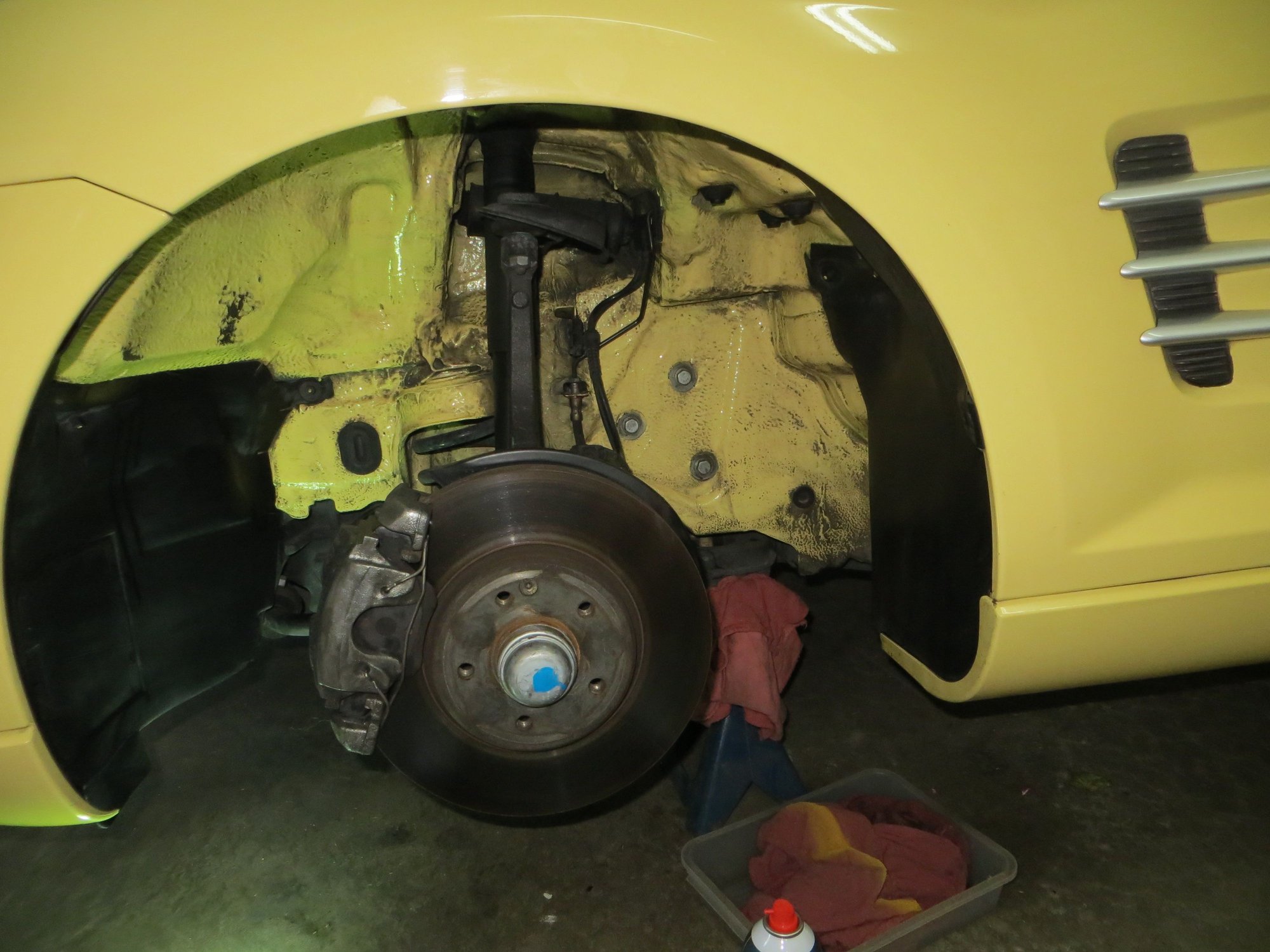

Why not just remove the wheels, spray clean the brakes with Brake Clean or something alcohol based, wire brush, mask everything off, then spray the calipers with VHT paint in a rattle can. You only need to paint the outsides as the insides never show anyway
All masked and painted with a rattle can
Prepped and ready to paint
. That's what I did. Careful about over spray. Great finish, unless your going for 100 points in a show.

Hi Coty49; I painted them in June and its a daily driver. Off the road from November to April. As long as you really clean the calipers and wire brush them the paint should stay. I used VHT Caliper Paint. Just pulled the wheels again to restore the rims and all calipers are like the day I painted them. I also painted the edges of the rotors for a little different look when the wheels are on. I also cleaned off 15 years of dust and road tar from inside the wheel wells. Plan to touch up the paint on them as well using my airbrush. Got a perfect paint match from the PPG Dealer. Clean up rotor over spray with a blade and some lacquer thinner. The VHT paint is available in different colours. Couldn't see spending 1000 bucks for painted rotors.
