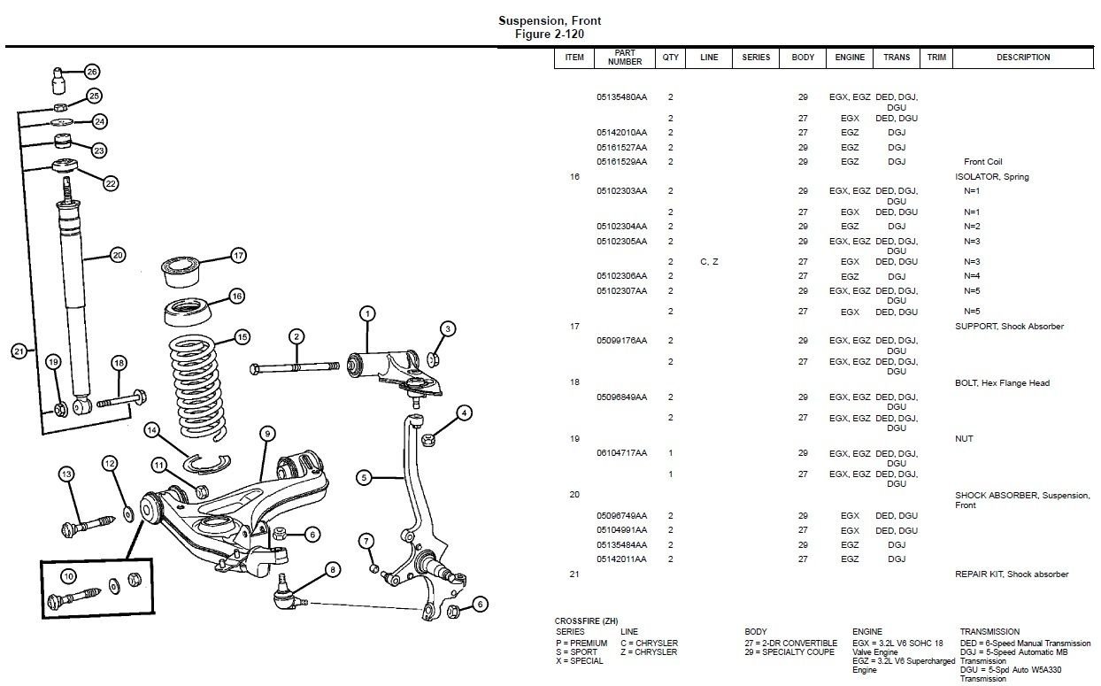

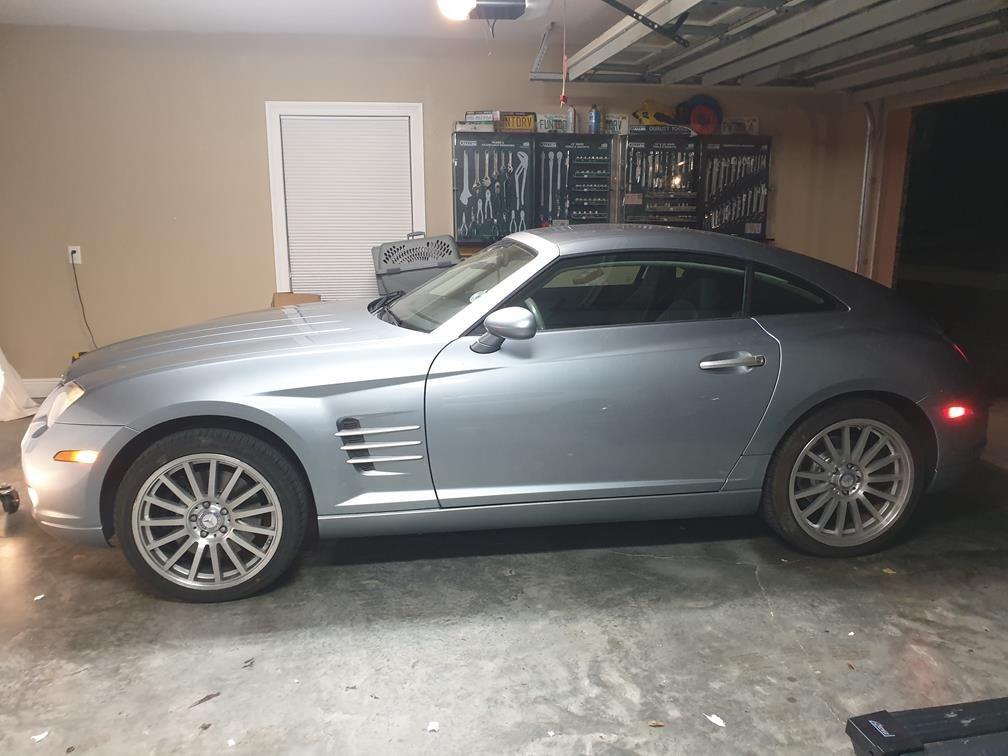

I am in the process of modifying a 2004 Limited Coupe. I have an SRT6 coupe parts car, and harvested the brakes and suspension from it. I purchased all new control arms, ball joints up front, and all new links and control arms for the rear from FCP, along with new Bilstein B6 shocks all around. Other than being a lot of work, the swap was very straightforward, with few gotchas along the way, save one. The rear of the car seems to sit the way I would expect, but the front end sits VERY high. Like 4x4 high. I did use the Limited's front spring upper isolators, as they were in better shape, along with the Limited's spindles. Looking at the isolators, I didn't notice any major height difference, but the car sits at least 1" too high, maybe closer to 1.5". Take a look at the before and after pics. Was there some difference in spring perch location on the 2004 vs the later years? I am missing something obvious, because nothing should be this far off. BTW, it drives fine, and it was aligned. I want to drop it back down, and then align again (I have a lifetime alignment on the car, so I can go back as often as I need to). Below is a pic of the car before I modified anything on it. As you can see, the ride height all looks normal.
But here you can see the front end ride height is way off.
I can fit my whole hand in there, so there is about 4" of clearance!
The rear seems much more reasonable, and seems to be about the same as another 04 Limited we own.
I can see that there are several different spring isolators listed (Part #16), but the parts catalog doesn't seem to show what is for what. Unsure what the N=1, 2, 3, 4, 5 is about.

....and perhaps the isolators are at least part of the answer. Check out this same page in the parts manual, but from the 2004 MY. Explains what the N=x means, I'd say. Time to dig back into the thing, I'd say.

In 2006, there was but one choice for the EGZ (supercharged) engine. That part number traces back to being N=2, or 9mm. Actually, there is no listing for the NA engine, but that is obviously an error. There are numerous errors in the ZH parts catalogs, compared to pretty well all other Chrysler models.

I put the car up in the air, and took the front springs out. Sure enough, the Limited's spring isolators were the N=3 or 13mm type. The SRT6's isolators were N=2, or 9mm. I replaced with the SRT6's. In addition, both front springs were "clocked" and not fully seated in the isolators. Correcting both of these items lowered the front end by well over an inch! We're still a bit high in the front end, but no where even close to as bad. I will post updated pics tomorrow.

If you need it lower use thinner upper spring isolators (#16), as you found,
The springs are "clocked", spring to isolators, but that isolator is free to be in any position (rotation) in the upper cup on the frame.
The lower end of the spring is also clocked to where it sits in the lower control arm and can be in only one position to sit at correct ride height.
The parts graphic shows an isolator for the lower end of the spring (#14) that looks simply like a pad for NVH. My car did not have those when I had to replace the broken stock springs.
