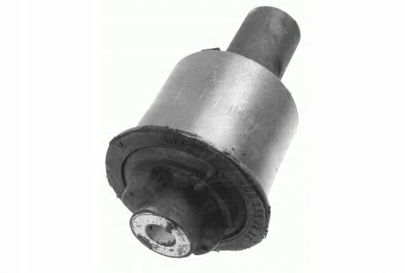

For some time now, my car has been pulling slightly to the right. I drove to a vehicle inspection station, and the service technician said the rear bushings in both front control arms needed replacing.
I found this offer from a Polish seller:
https://allegro.pl/oferta/tuleja-wah...um-16325390481
The offer states that the part fits a Mercedes SLK320 (R170) V6 3.2.
But I wanted to make sure if any of you have replaced these bushings in your Crossfire and can confirm they are the correct ones?

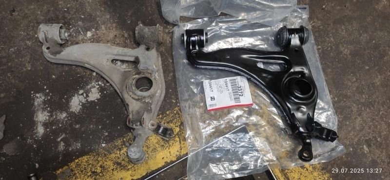

Today, a courier delivered new left and right front lower control arms with bushings and both ball joints from LEMFORDER.
These parts cost me $270.
I have an appointment with a mechanic on Monday to replace them in my car.

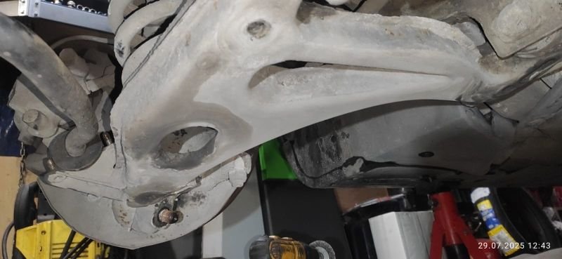

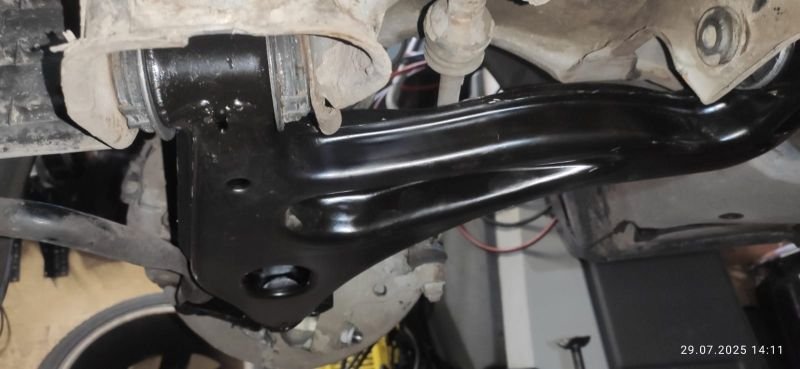

Last week, the mechanic replaced both front lower control arms along with the ball joints with new ones.
The labor cost was $140.
Then I went to another workshop, where they performed a wheel alignment and set the geometry – that cost $55.

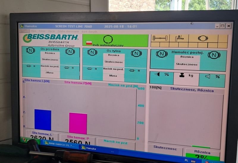

Today at the vehicle inspection station, I checked the brakes – the photo below shows that the braking forces on both front wheels are equal. The results were similar on the rear axle.
I expected the brakes to be okay because the car pulls to the right in each of these three situations:
1) when I accelerate
2) when I don't accelerate
3) when I brake
