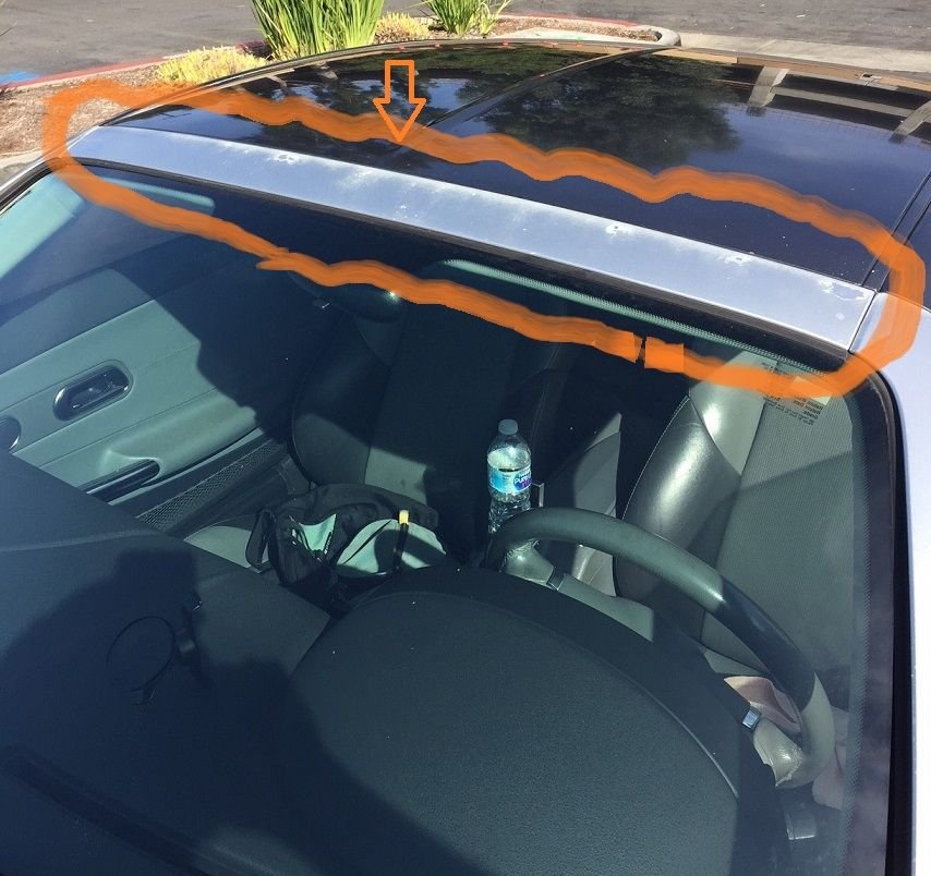

Hello all. Not sure what the actual name of this part is, so I am including a photo of it. It is the silver trim/panel above the front windshield. As you can see from my photo, mine is starting to deteriorate in certain places. Looking for one in better shape and simple instructions on how to replace.

Most of the time it is just the clear coat peeling. off the windshield surround.
Way cheaper to remove all 3 pieces and take them to your local body shop and have them painted. Have them painted silver or match your car color.

Unless you get lucky it would be cheaper to paint the one you have and make sure it is reattached properly or you will lose it.

Use a tool like a hard plastic puddy knife. Slide it under the trim molding from the windshield side. Gently pry up. Scary but it will come off fine. James
